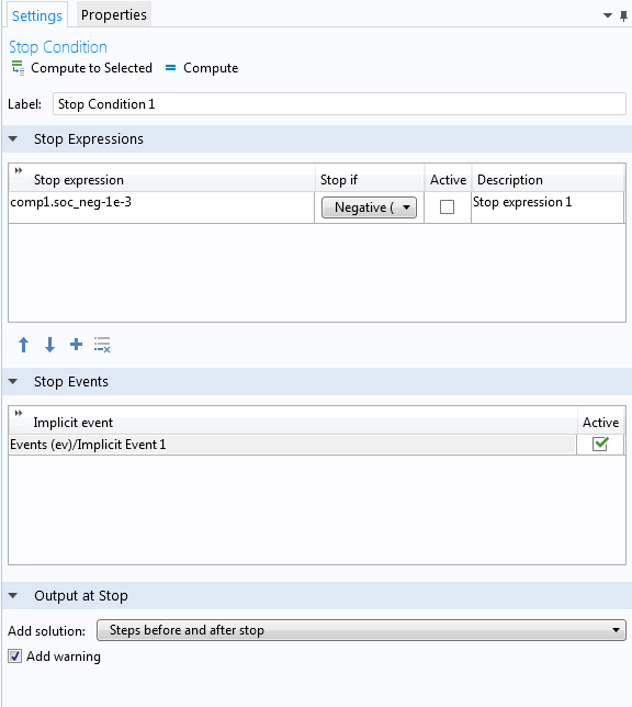

Stop conditions cannot be more accurate than the local time stepping. It stops at the first time when the condition becomes false . For a more accurate stop condition in time-dependent models, you can use events (in the Events interface). In the attached model (solved using COMSOL 5.1), I have added an Implicit Event for the stop condition comp1.soc_neg-1e-3<0 and used the Event tolerance setting (in the Time Stepping section in the Time-Dependent Solver node's Settings window) to provide an accurate stop. I have also added the solutions at the steps just before and after the event to the solution. I have attached a screenshot of the new settings for the stop condition.

Posted: 1 decade ago 2015/04/27 10:07 GMT-4
Thanks a lot Magnus!
That is right! Actually, I was thinking about using events instead of stop condition, however, I did not know how. Could you please tell me in adding solution what the steps before and after stop is for?

Magnus Ringh COMSOL Employee
Posted: 1 decade ago 2015/04/27 10:51 GMT-4
Hi Barzin,
Normally the solutions stored from the time-dependent solver are the solutions specified in the Times to store list for the time-dependent solver. The option to store the solutions before and after the stop condition has been fulfilled makes sure that the solutions available for postprocessing include the solutions for the times as close to the time when the stop condition is fulfilled as possible. You can then choose to store only some solutions and not all the solver steps up to, and after, this point in the time-stepping process.
