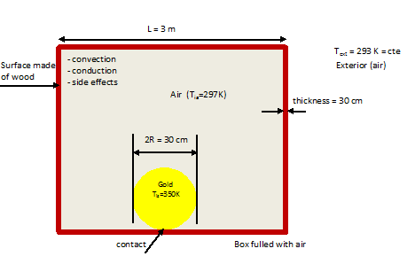

To be clearer, my sphere is enclosed in the box fulled with air. The sides of this box are made of wood and the system {sphere + box} is embedded in air (infinite medium). According to experiments, the finite size of the box is to be taken into account in the calculations of the cooling of the sphere and all of the physical phenomena relating to the cooling of a hot body (convection, conduction...).
The box represents a wooden house...The design can be seen in attached file.
Than you for your help.

Hi Daniel, Thank you for your reply ! To be clearer, my sphere is enclosed in the box fulled with air. The sides of this box are made of wood and the system {sphere + box} is embedded in air (infinite medium). According to experiments, the finite size of the box is to be taken into account in the calculations of the cooling of the sphere and all of the physical phenomena relating to the cooling of a hot body (convection, conduction...). The box represents a wooden house...The design can be seen in attached file. Than you for your help. KB
