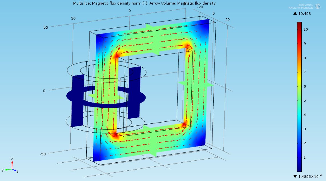

I am simulating an electromagnet dipole and I would like to simulate the iron as a laminated core instead of a solid core.
Is there any way to set the filling factor and the lamination directio or I should design each layer (which would be crazy)?

Hi Francesco,
You can try to define anisotropic conductivity of the core material.

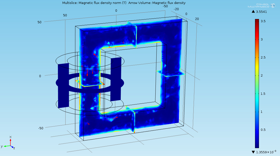

Posted: 1 decade ago 2015/05/06 20:56 JST
Thank you for your answer.
Is there any example I can use as a reference?
Thank you for your answer. Is there any example I can use as a reference?
Posted: 1 decade ago 2015/05/07 14:14 JST
Hi Francesco,
Check the attached model.

Dear Dima,
I would like to ask you something regarding your model:
1) how do you take into account the fact that your core is missing a certain percentage of magnetic material?
I mean, if laminated, the core will be made of layer of metal and insulator, henche the core will have a magnetic material volume smaller than 100% of the yoke volume. This can be described by a filling factor usually, but I don't know how to set it i comsol.
2) I use single coil turn with an inner surface as gap feed. There are advantages in using the multi turn coil, as you did?
Thanks
Francesco
Dear Dima, I would like to ask you something regarding your model: 1) how do you take into account the fact that your core is missing a certain percentage of magnetic material? I mean, if laminated, the core will be made of layer of metal and insulator, henche the core will have a magnetic material volume smaller than 100% of the yoke volume. This can be described by a filling factor usually, but I don't know how to set it i comsol. 2) I use single coil turn with an inner surface as gap feed. There are advantages in using the multi turn coil, as you did? Thanks Francesco
Posted: 1 decade ago 2015/05/11 13:55 JST
Hi Francesco,
1. The attached model was just an example of how to use material conductivity settings in order to prevent undesired eddy currents in the core. There is no (as far as i know) straightforward way to define core filling factor. You can reduce core permeability (depends on the permeability settings you use) in order to get the desired flux.
2. Sure, any type of coil and excitation can be used. Multi-turn coil was used just for the example.

Posted: 1 decade ago 2015/05/11 21:46 JST
Regarding the influence of stacking, there is one suggestio that I have put
Arxiv some time ago:
arxiv.org/abs/1212.5163
Regards
Jens
Regarding the influence of stacking, there is one suggestio that I have put Arxiv some time ago: http://arxiv.org/abs/1212.5163 Regards Jens

Posted: 1 decade ago 2015/05/21 14:51 JST
Dear Francesco,
in order to implement this in Consol I had to use advanced feature. So, first
swithch on the "Equation view", so that for each feature you can inspect and
edit the implementation.
What the maths eventually gives you is a function to calculate Hx, Hy, and Hz
from Bx, By, and Bz. I suggest that you implement these as expression in a
"Variables" node.
For the domains of the lamination you add an "Ampere's Law" feature and go to
the equation view. Then you replace the expression defining Hx by the expression
defined above (same for y and z).
That should do it, but it took me some time to get it all correct.
Good luck.
Jens
Dear Francesco, in order to implement this in Consol I had to use advanced feature. So, first swithch on the "Equation view", so that for each feature you can inspect and edit the implementation. What the maths eventually gives you is a function to calculate Hx, Hy, and Hz from Bx, By, and Bz. I suggest that you implement these as expression in a "Variables" node. For the domains of the lamination you add an "Ampere's Law" feature and go to the equation view. Then you replace the expression defining Hx by the expression defined above (same for y and z). That should do it, but it took me some time to get it all correct. Good luck. Jens
