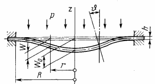

I'm trying to model pressured round membrane in Solid Mechanics. The situation is shown in the attached diagram. The task is to define maximum stress, which appears near the membrane-to-fixed attachment. Pressured surface I described as Boundary Load -> Pressure. And I got analytical formulae to calculate maximum stress, but model results differ.
The thing is I'm not sure how to model boundary conditions. I tried Fixed Constraint surfaces on the edge of the membrane or adding Rigid Domain binding rings (as in the picture), not sure about Roller Connector. As I can see, the finer mesh I make the higher stress values I got near attachment.
So any advice how to make realistic boundary conditions would be helpful.
I made 3D geometry due to my membrane is quite thick.
