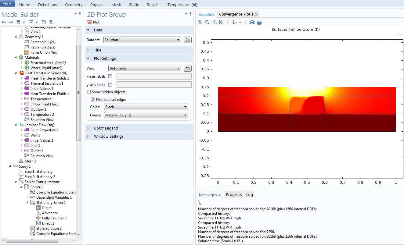

Well the nice thing with COMSOL it's easy to make a simple "test model", see below
still the strange thing is that:
1) First try with only 1 Heat inflow with q0=0 and T=T0+2/3*DT did NOT give the expected result
2) by adding in the total heat flux q0=1.24E5[W] as found for a constant Temperature input I do not get the same results, I must add a T=T0+2/3*DT/4, why "/4" ? to have the same as for a constant T BC
3) by adding a second Heat Inflow node and this time setting q0=0 and T=T0+2/3*DT I do get the expected results ?
=> is there something wrong ?, perhaps worth to repeat with a fresh model from scratch and/or ask support
update, I tried again with a fresh model, this time it works as expected: see HTtst2 (v5.1)

DT is a delta Temperature step in [K]
OK I tried it again in V4.4 => failure to converge and to include correctly the temperature of the fluid inflow, as well with a T=cte BC as for the heat influx !?
but it works in the V5.1 by insisting a bit, both as T=cte BC and as inflow with no extra Q but only a T
I would suggest that you get "support" to explain
