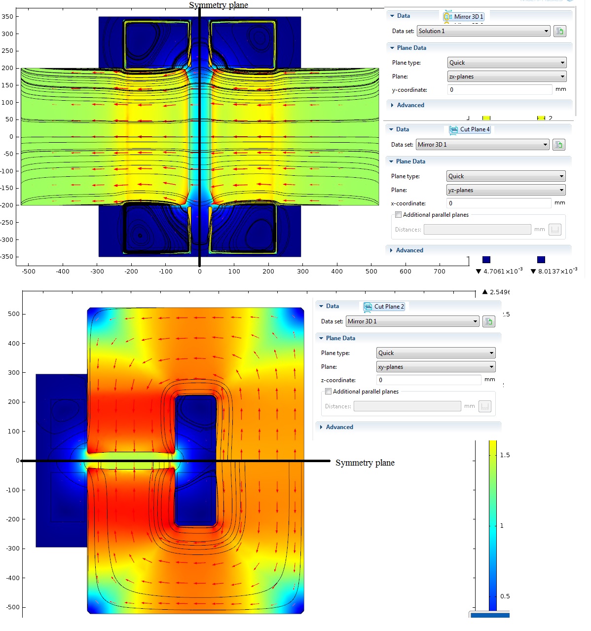

Hello Ivar,
Sorry, but I don't get your advice.
I define the cross plane on zx at y=0, to cut my geometry and solved it. On this plane I set PMC condition.
In dataset I define a Mirror 3D for Solution one, setting zx plane at y=0.
Now if I define a yz cutplane for the Mirror 3D dataset I have the correct solution of the model (magnetic field flows in only one direction along the yoke)
If I set a xy cutplane for the Mirror 3D the magnetic field flows in two directions and the plot look abviusly wrong.
PLease have a look at the attached image.
I did not used any other periodicity or bounduary condition to solve the model, only the PMC.
Hello Ivar, Sorry, but I don't get your advice. I define the cross plane on zx at y=0, to cut my geometry and solved it. On this plane I set PMC condition. In dataset I define a Mirror 3D for Solution one, setting zx plane at y=0. Now if I define a yz cutplane for the Mirror 3D dataset I have the correct solution of the model (magnetic field flows in only one direction along the yoke) If I set a xy cutplane for the Mirror 3D the magnetic field flows in two directions and the plot look abviusly wrong. PLease have a look at the attached image. I did not used any other periodicity or bounduary condition to solve the model, only the PMC.

OK I believe I got it, (its easier to understand with an image ;) but in your case its not a simple symmetry plane, as your flux is going through the plane=> anti-symmetry for the flux there
Clear the mirror condition with a symmetry condition will invert the arrows !
Some symmetry cuts, in multi-physics, need to be set accordingly (symmetry and/or anti-symmetry) depending on the physics

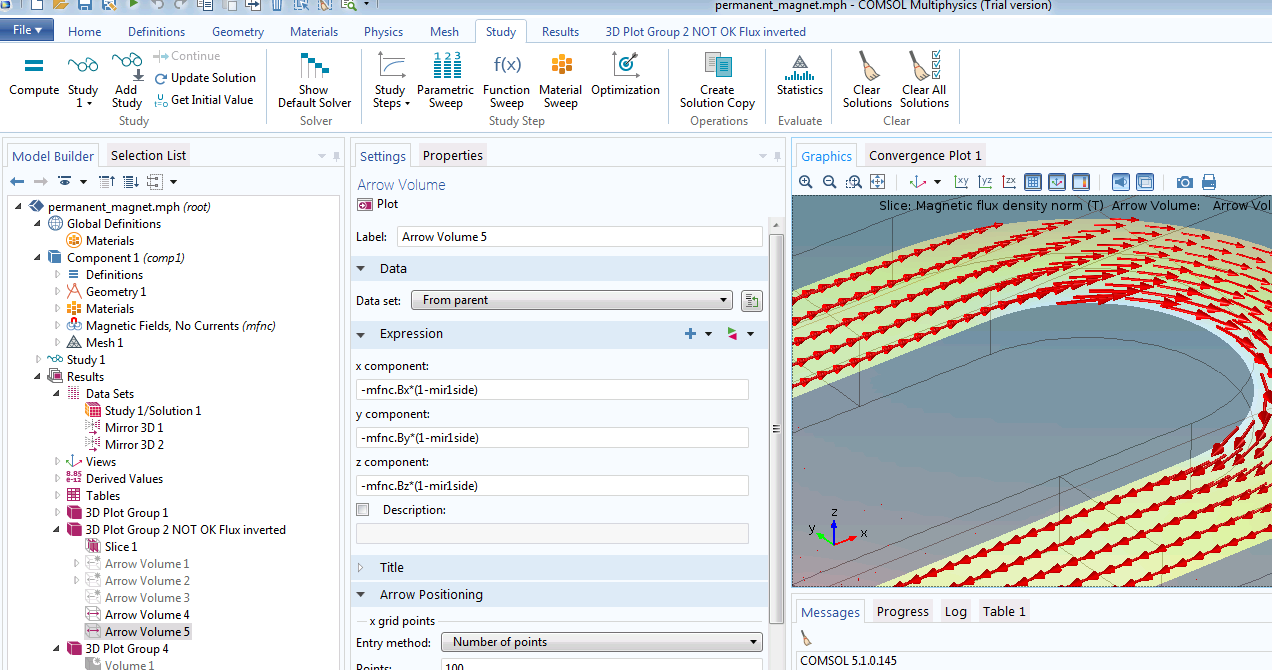

Hi here you have an idea
You must turn on the Advanced feature to define "mir1side" and then
the Arrow plot 4+5 do work, while Arrow 1,2 & 3 do not or give strange error messages for case #2 while #3 should also work
the model file is in V5.1
Hi here you have an idea You must turn on the Advanced feature to define "mir1side" and then the Arrow plot 4+5 do work, while Arrow 1,2 & 3 do not or give strange error messages for case #2 while #3 should also work the model file is in V5.1 -- Good luck Ivar

Sorry I do not have access to any earlier version from home ;)
But if you copy the formula from the image PNG file you should manage, the formula for arrow 4 is
+mfnc.Bx*mir1side
etc for y,z
And you "turn on" the variable "mir1side" under the Data Set Mirror node Advanced Tab => select tick on

This is what I did, but doesn't work...
