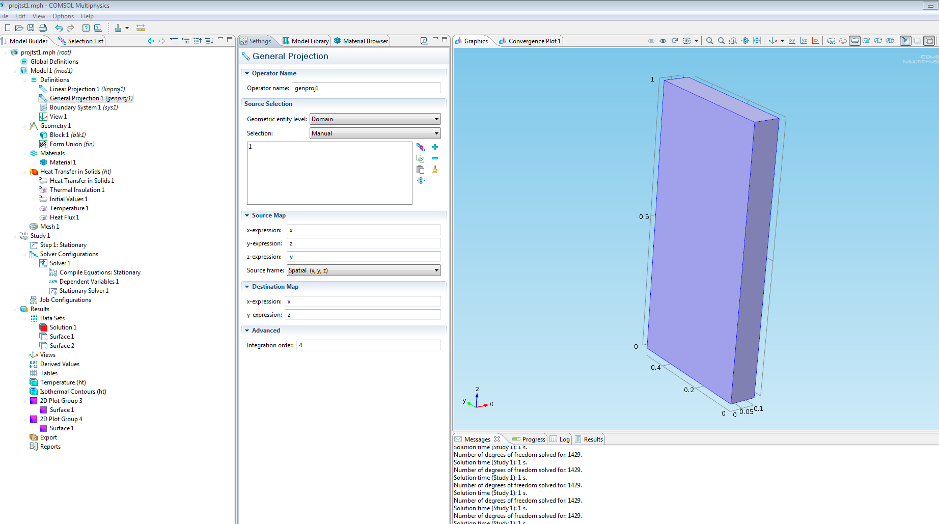

Hello All. I have a similar problem:
My domain is a 3D bloc (L*W*H), I calculate a variable C (x, y, z) in this domain.
I need to define a parameter Cs (x, y) on one face of the bloc (z=0) as the integration of C along the normal axis (z) of that face. Cs (x, y) = $(from z=0 to z=H) C(x, y, z) dz
Cs will be used in the calculation of C.
So should I define an integration? an Extrusion? is it possible?

Posted: 1 decade ago 2012/06/07 22:43 JST
It's rather the projection operator you should use that integrates over the last variable (if you want an average, divide by the total line length
I have attached a simple example hereby but its 4.2a ;)
Hi It's rather the projection operator you should use that integrates over the last variable (if you want an average, divide by the total line length I have attached a simple example hereby but its 4.2a ;) -- Good luck Ivar

Posted: 1 decade ago 2012/06/07 23:04 JST
Hello Ivar.
Thanks a lot! Your help is very much appreciated.
So in this case I should define Cs=genproj1(C) right?
BTW Why is it integration order 4?
PS: thanks for the information and solving my problem, but in the general case, how do I know if I need a projection or an extrusion, linear or general....? is it like 3D -> 2D = projection and 2D ->3D = extrusion? I mean what is the reason to choose those names? for me in real life, a projector takes a 2D picture and projects it in a 3D domain, pretty much the same as an extrusion, which translates a 2D shape to form a 3D volume... I'm not a native english speaker but those words are not clear to me...

Posted: 1 decade ago 2012/06/08 13:51 JST
you can use both (generic or specific), but their set-up is slightly different, in one you use the geometry (points/vertex) in the 2nd you use the generic coordinate system topdefine the orientations and the integrand.
Note: both of them perform an integration hence you add a *1[m] on the units from the ds term. This is OK for flux or density variables, for global variables when you want an average output, you need to normalise by the integration length.
Projection and extrusion are opposite (in some sens) operations. The best is to carefully read the doc (2-3 times ;) it has taken me quite some time to catch the essence behind these operators, but I have still not found a simpler way to explain how it works, and I still make small examples as the previous posted one to check that I get the right operator and that I use it correctly
Hi you can use both (generic or specific), but their set-up is slightly different, in one you use the geometry (points/vertex) in the 2nd you use the generic coordinate system topdefine the orientations and the integrand. Note: both of them perform an integration hence you add a *1[m] on the units from the ds term. This is OK for flux or density variables, for global variables when you want an average output, you need to normalise by the integration length. Projection and extrusion are opposite (in some sens) operations. The best is to carefully read the doc (2-3 times ;) it has taken me quite some time to catch the essence behind these operators, but I have still not found a simpler way to explain how it works, and I still make small examples as the previous posted one to check that I get the right operator and that I use it correctly -- Good luck Ivar
