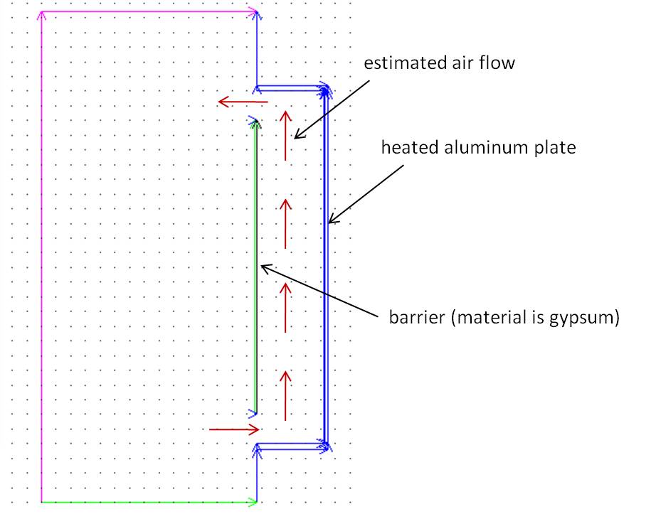

I have problems solving my COMSOL model. I want to simulate an air flow caused by a heated aluminum plate. To simulate this, I have chosen the combination of weakly compressible navier- stokes (chns) and general heat transfer (htgh).
There is a heated aluminum plate and a barrier in front so there must be an air flow as shown in picture_1.jpg. The problem is that the solution does not converge. The red arrows show the air current schematically.

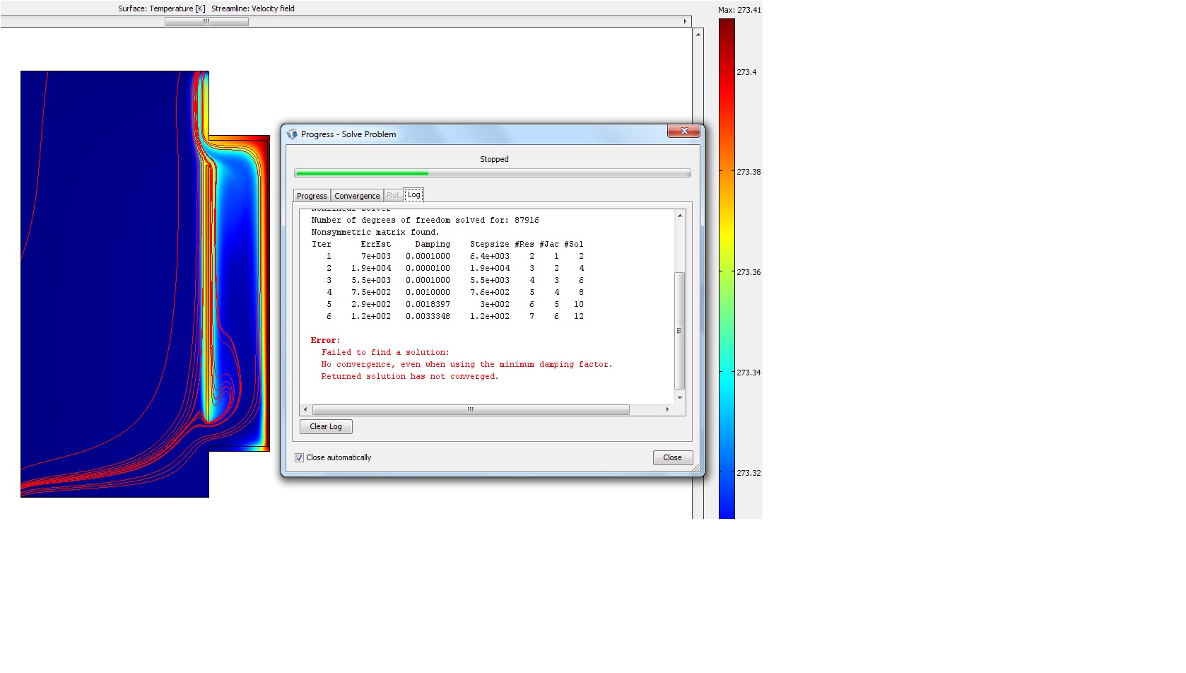

In picture_2.jpg you can see my current solution. The temperature profile looks realistic, but the whole temperature scale is near 273 K. This is the start temperature of all parts in this model.
