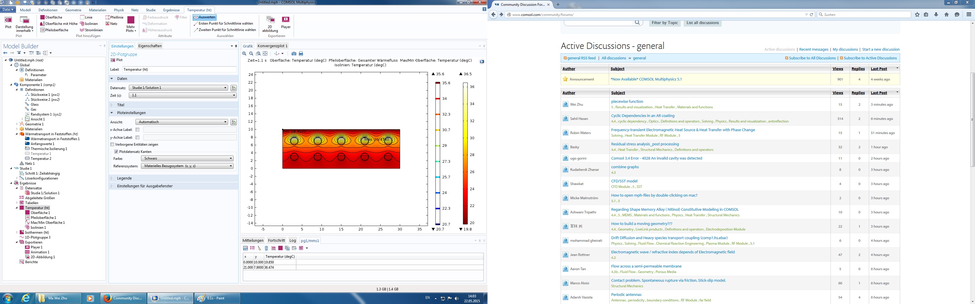

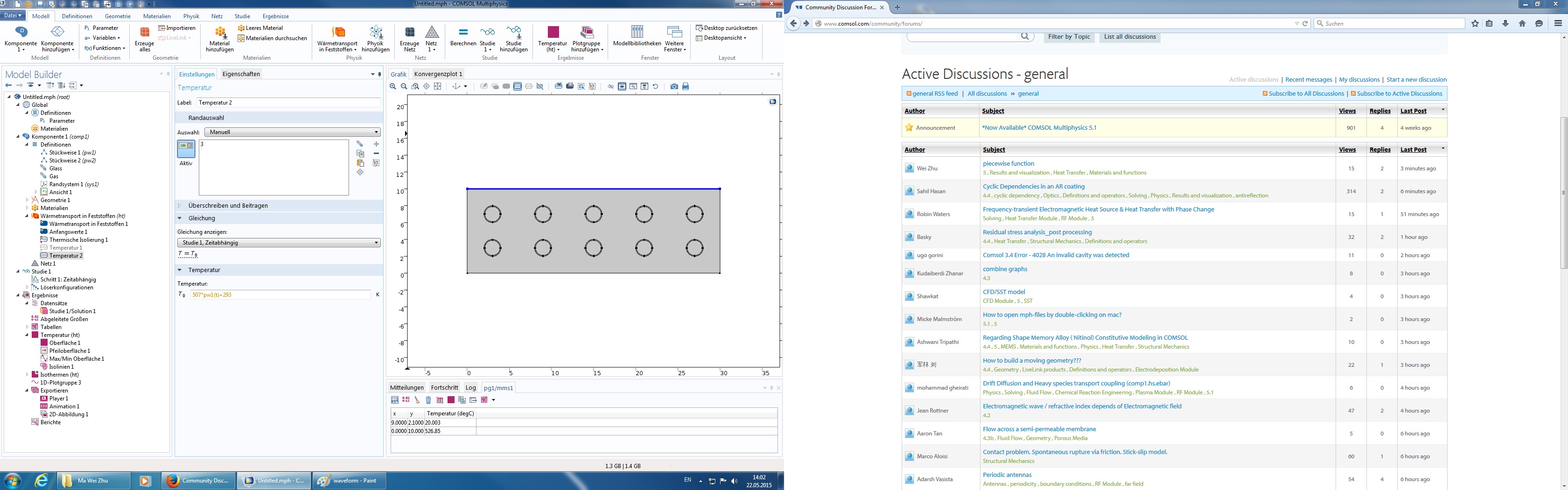

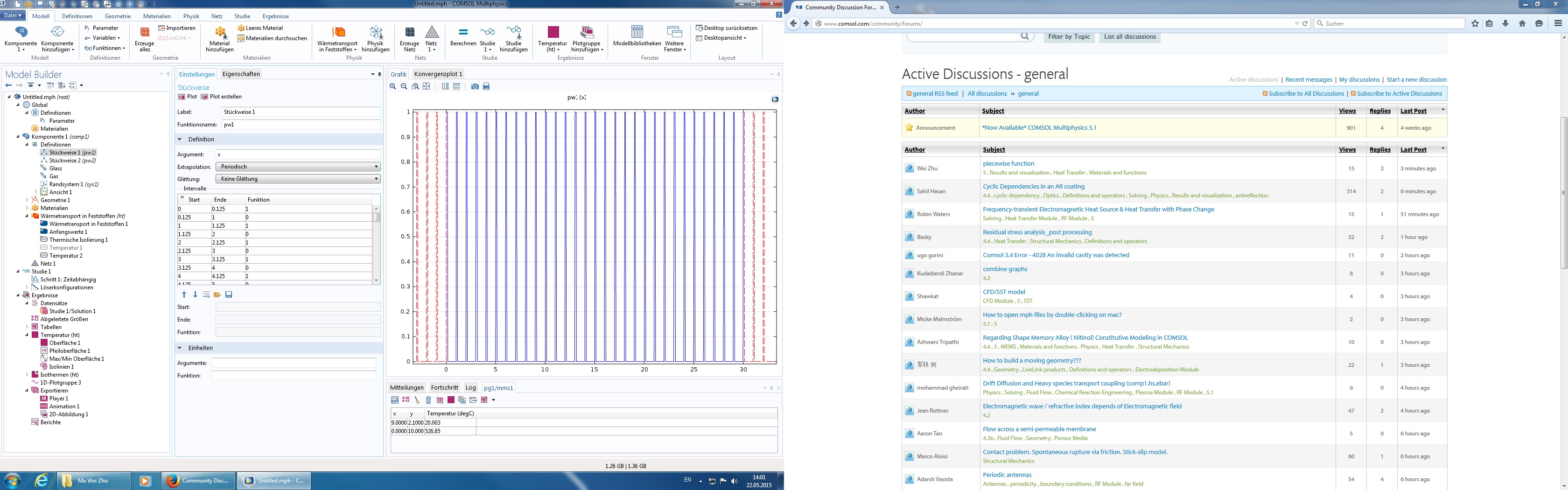

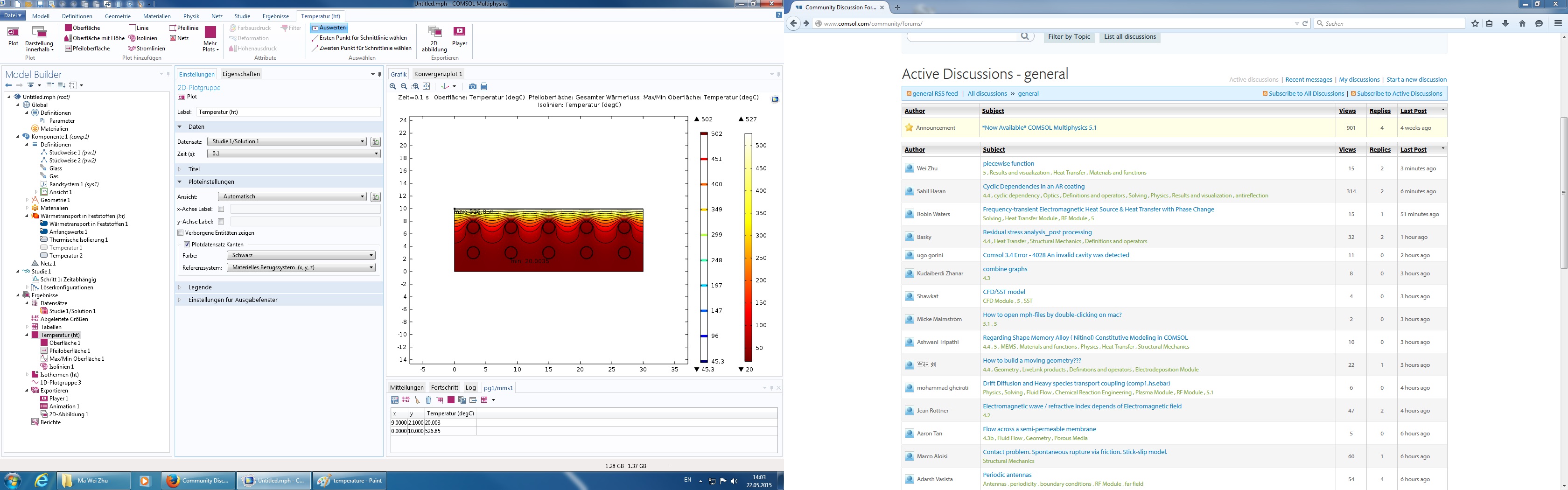

Thanks Lasse. I have upload some pictures about the waveform, the temperature, temperature distribution at 0.1s, at 1.1s. So the problem is the temperature at 1.1s.
[QUOTE] I mean that when the solver takes time steps, it may jump over your pulse. I had this problem a few years ago, when I had a very short pulse every hour. I had to define solver time stepping explicitly so that the solver was able to "see" the pulses. Lasse [/QUOTE] Thanks Lasse. I have upload some pictures about the waveform, the temperature, temperature distribution at 0.1s, at 1.1s. So the problem is the temperature at 1.1s.

Do you still have argument name x, as in your jpg-image?
