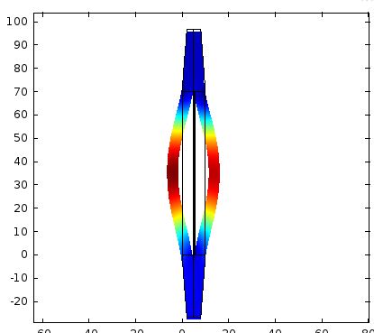

Jeff Hiller COMSOL Employee
Posted: 1 decade ago 2015/06/05 21:10 JST
Hello Qingbo,
The model in your file is not set up as a contact problem.
For an introduction on contact modeling, read the Structural Mechanics Module's User's Guide, version 5.1, page 121 and following.
Hello Qingbo, The model in your file is not set up as a contact problem. For an introduction on contact modeling, read the Structural Mechanics Module's User's Guide, version 5.1, page 121 and following. Best, Jeff

Hi friends,
I also having the problem of deformation above the physical limit. In my geometry there are 3 layers. The first one is an epoxy layer, Middle one is a glass fiberand the third layer is again the same epoxy material. While a mechanical load is applying on the outer layers , each domain moves beyond the physical limit. Please see the attached image. How Can I solve this issue.
Please send your valuable suggestions
