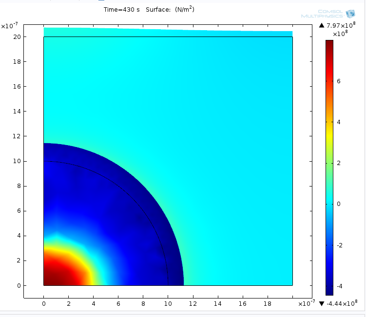

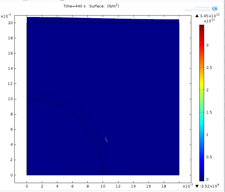

Recently I encountered a problem. When I used solid mechanics module to simulate the thermal expansion deformation of a particle-matrix system(a sphere particle included in a matrix, axi-symmetric model). I cannot converge at some time. As fig. t430 and t440 shown, when time is 430s, the result is right while when time is 440s, the calculation cannot converge. However, if I only simulate the expansion of this particle, it can work well. So I want to make sure if it is the interface causes the problem. Is there any ways to deal with it? Thanks!

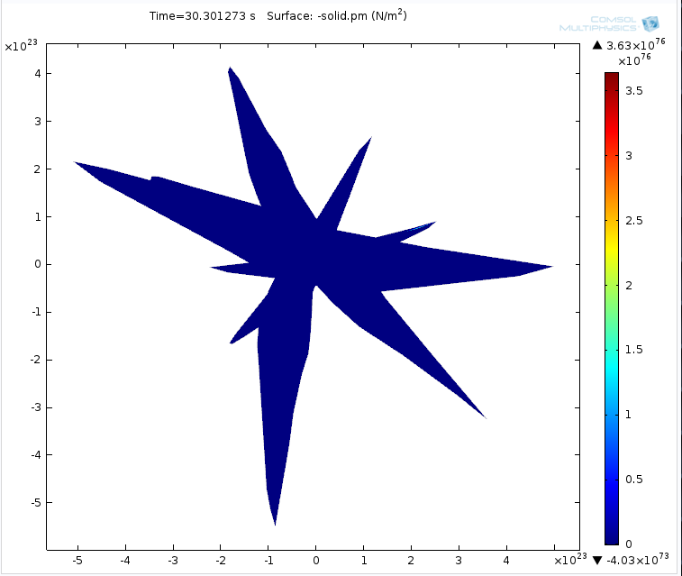

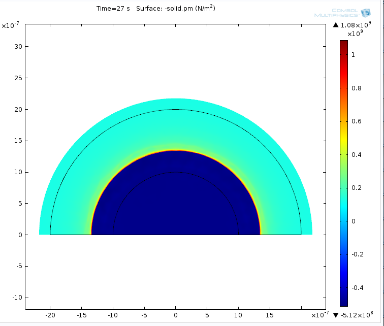

I also found when I even added a homogeneous temperature field on the center part, it cannot converge at some time. I think it is a very simple problem with large deformation, and in ABAQUS it can work well. But I don't know why I cannot handle with it in COMSOL. Attached is the pressure at different steps. Thanks!
Rong
Hi, I also found when I even added a homogeneous temperature field on the center part, it cannot converge at some time. I think it is a very simple problem with large deformation, and in ABAQUS it can work well. But I don't know why I cannot handle with it in COMSOL. Attached is the pressure at different steps. Thanks! Best, Rong

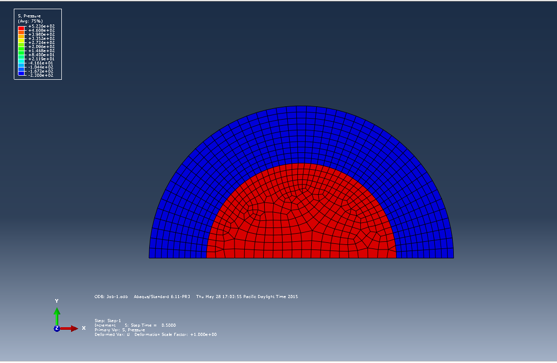

Attached is the result from ABAQUS.

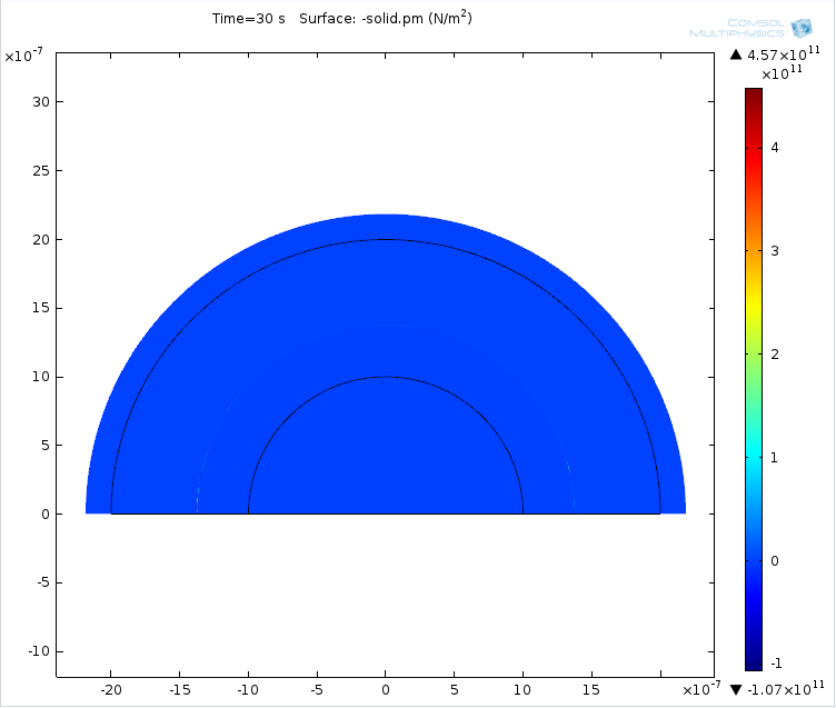

Hi Jeff,
Thanks so much! This model is just a simplified model. Even I build an axis-symmetric model (attached is that axis-symmetric model). It cannot converge yet. So I think it is not because of the axis-symmetric frame. Is it because the difference of Young's Module between two materials is two large?
According to the thermal expansion coefficient, finally I need a 50% thermal strain, so for simplification I set CTE equals to 1 and the temperature equals 50 0.5. Of cause I can define CTE as a smaller value while the temperature gradient would increase. So I think the result is the same. Thanks!
Rong
Hi Jeff, Thanks so much! This model is just a simplified model. Even I build an axis-symmetric model (attached is that axis-symmetric model). It cannot converge yet. So I think it is not because of the axis-symmetric frame. Is it because the difference of Young's Module between two materials is two large? According to the thermal expansion coefficient, finally I need a 50% thermal strain, so for simplification I set CTE equals to 1 and the temperature equals 50 0.5. Of cause I can define CTE as a smaller value while the temperature gradient would increase. So I think the result is the same. Thanks! Best, Rong
