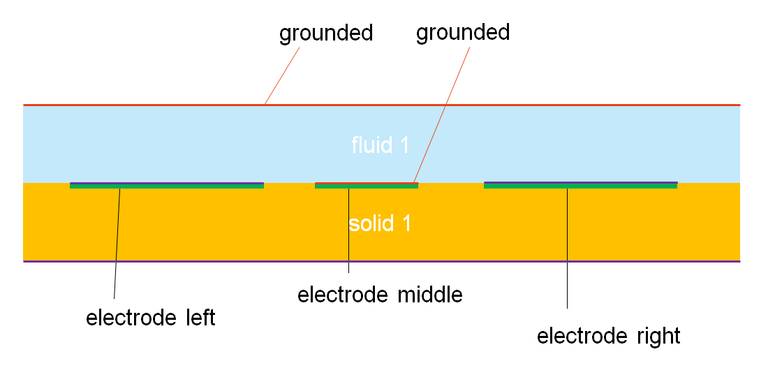

Hi I saw your discussion and I want to do exactly the same.
I have 3 electrodes (see figure attached). I want to know the capacity of each electrode with the grounded on the top of my box. I tried to implement everything as in your "capitance matrix.mph" file.
I have two grounds. I don't know if the matrix calculates the capacitance from the electrodes to the ground on the top of my box. Or the capacitance to my middle electrode, which is at ground.
How can I see which capacitance it gives me?
(and a small other question, if I apply a terminal on a good conductor, it is sufficient to just assign the terminal to one surface of the conductor, or do I have to select all surfaces)
