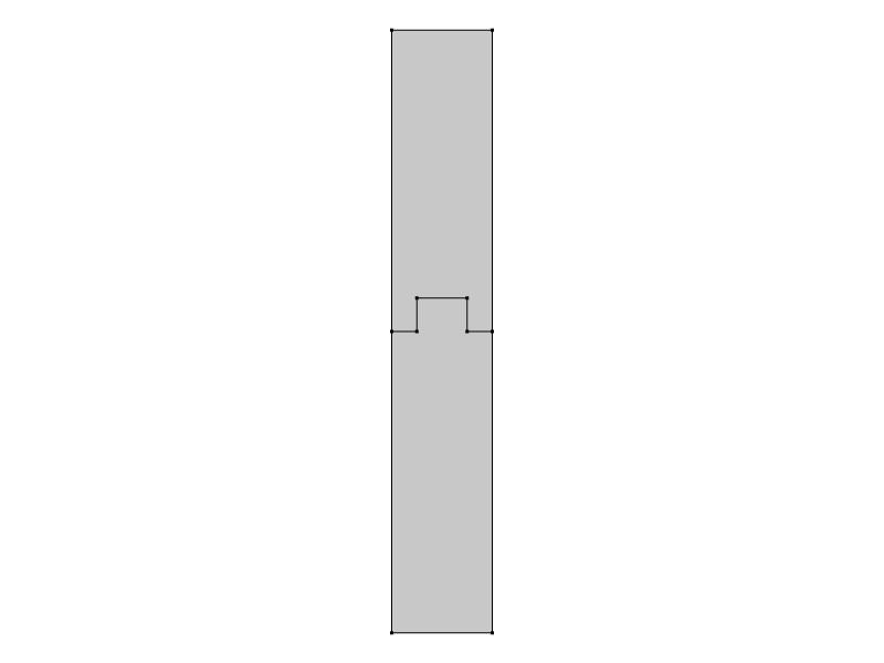

I am trying to simulate the reflectivity and transmitivity of different wavelengths of light on a periodic surface structure.
1) I am using a 2D simulation using the RF module to create a basic cell with two media air and silicon and am trying to repeat it for the entire structure (periodic condition on side walls). I plan to have a electromagnetic wave incident on it (first TE and TM then average it out).
2) I plan to input the refractive index of silicon for different wavelenghts and use this for the simulation over the entire wavelenght range using a parametric sweep. Refractive index is the only material property I have specified.
3) I have used two ports, one for the input of a plane wave (and reflectivity) and one after the silicon side to find the transmitivity.
Is this right approach? I am unable to get reliable results as the values of R and T are fluctuating rapidly (between 0 and 1) over the wavelenght range. Could someone please throw some light on the above problem. I have attached images of the geometry and my results below.

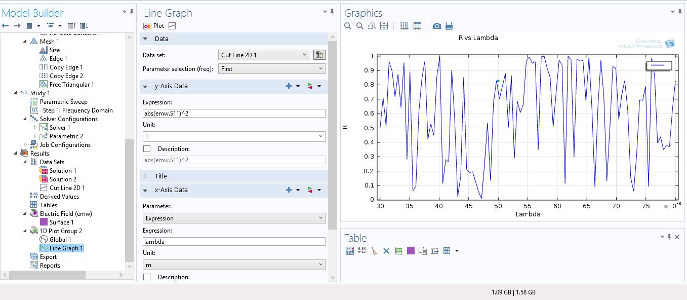

1) As for the physics I have used the wave equation (EM frequency domain) with electric displacement field model: refractive index. I have used 2 periodic ports one for input from above and one for transmission below. I have used a Floquet periodicity condition on both sides of the geometry and the k-vector from periodic port. Is there anything I might need to check in the periodicity condition?
2) I will try the simulation with multiple channels instead of a single unit and see if it solves the problem.
3) In order to simulate over a broad band of wavelenghts, I have created a parametric sweep for lambdas and plotted them against abs(emw.S11)^2 and abs(emw.S21)^2 where 1 and 2 are the input and output ports respectively to get the reflectivity and transmittivity plots. Is this the right approach?
Thank you for your inputs.
Edit 1: I am getting accurate results for reflectivity of plain silicon i.e. without creating any features but when I add features (to obtain periodic surface structures) the results fluctuate and some of the reflectivity values at certain wavelenghts are even higher than that of the untextured surface.
Edit 2: I have tried using multiple channels and I am still getting highly oscillatory results. Do you have any more suggestions? Thank you.

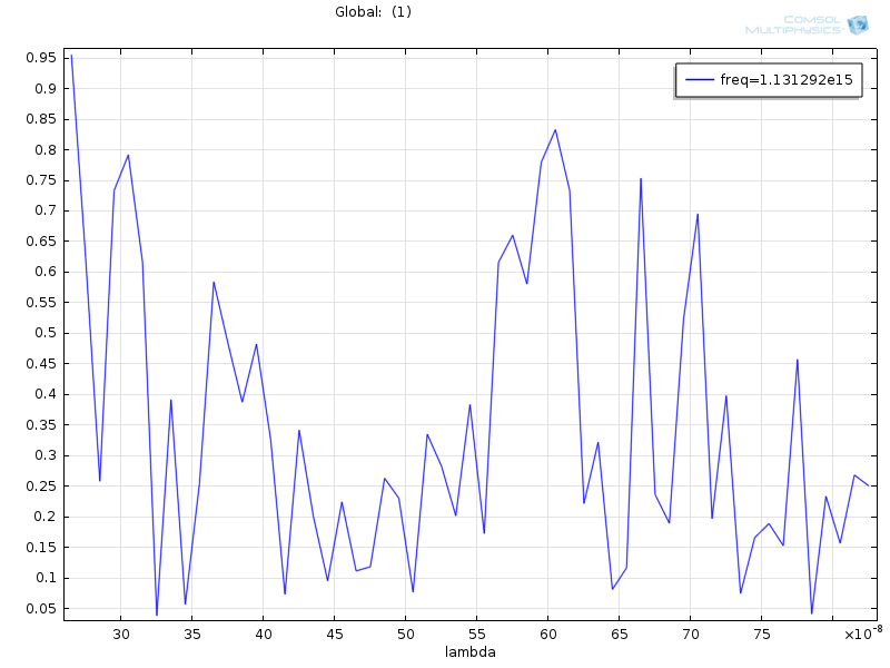

Posted: 10 years ago 2015/06/22 0:48 GMT-4
I am still not able to resolve the issue with the simulation. I have attached an image of the simulation results.
Also when I use a flat surface without any features, I am not getting the right reflactance values for higher angles of incidence but for normal incidence the values are correct. I am starting to wonder if that is the reason the simulation with features is incorrect as the values of reflectance for higher angles of incidence are incorrect.
Any comments on this would be appreciated. Thank you.
