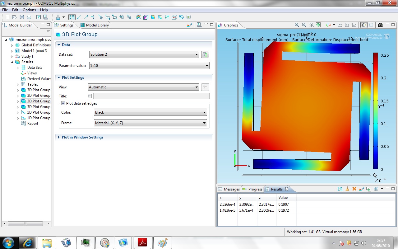

Hi Ivar - I am not sure what you mean by the above post - I was hoping to be able to see the X Y and Z co-ordinates of the cursor when it is hovering over the model in the graphics view.
I have now found a workaround - as when you click on a volume or surface plot of the model (provided you are within the plot area) the co-ordinates of the point you click on as well as the value being plotted at this point are shown in the results area. I've attached a screen grab showing this with one of the files from the COMSOL model library.
You'll see in my screen grab that I don't have anything written in the upper left side of the graphics view border. There doesn't seem to be anything when I undock the window either.
Thanks,
James
Thanks,
James

Posted:
2 decades ago
2010/08/05 4:18 GMT-4
Dear Fatemah,
If the measure isn't giving you what you want set up a results - domian plot (if you haven't solved the problem, add the mesh as a data set and plot the mesh quality: qual) and you should be able to click on points in the geometry with the resolution of the mesh. Unlike the measure tool clicking on something that isn't part of the geometry itself is allowed in this case.
Have a look at the .jpg I attached in the post above to see an example of this.
Cheers,
James
Dear Fatemah,
Cheers,
James
