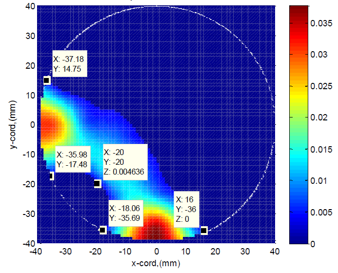

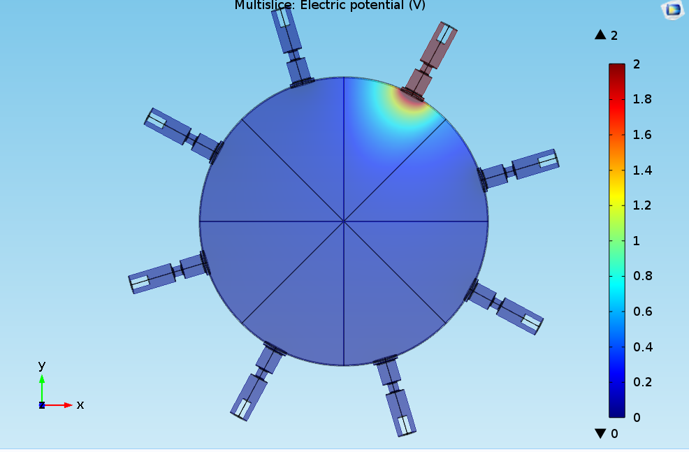

Attached is a picture of my model and those sensitive regions have coordinates;
1. I would like to know where to read the values of the centre of mass.
2 Also be able to read the x,y,z coordinates of those sensitive regions like the second photo attached.
Thanks tons.

Dear Smith, Thank you so much, this helped a lot but... Attached is a picture of my model and those sensitive regions have coordinates; 1. I would like to know where to read the values of the centre of mass. 2 Also be able to read the x,y,z coordinates of those sensitive regions like the second photo attached. Thanks tons. [QUOTE] Hi Onyekachukwu, you can simply go to Component 1>Definitions>Mass Properties. This will add a feature which computes the mass, volume, center of mass and other variables for the domains or boundaries you select. [/QUOTE]
