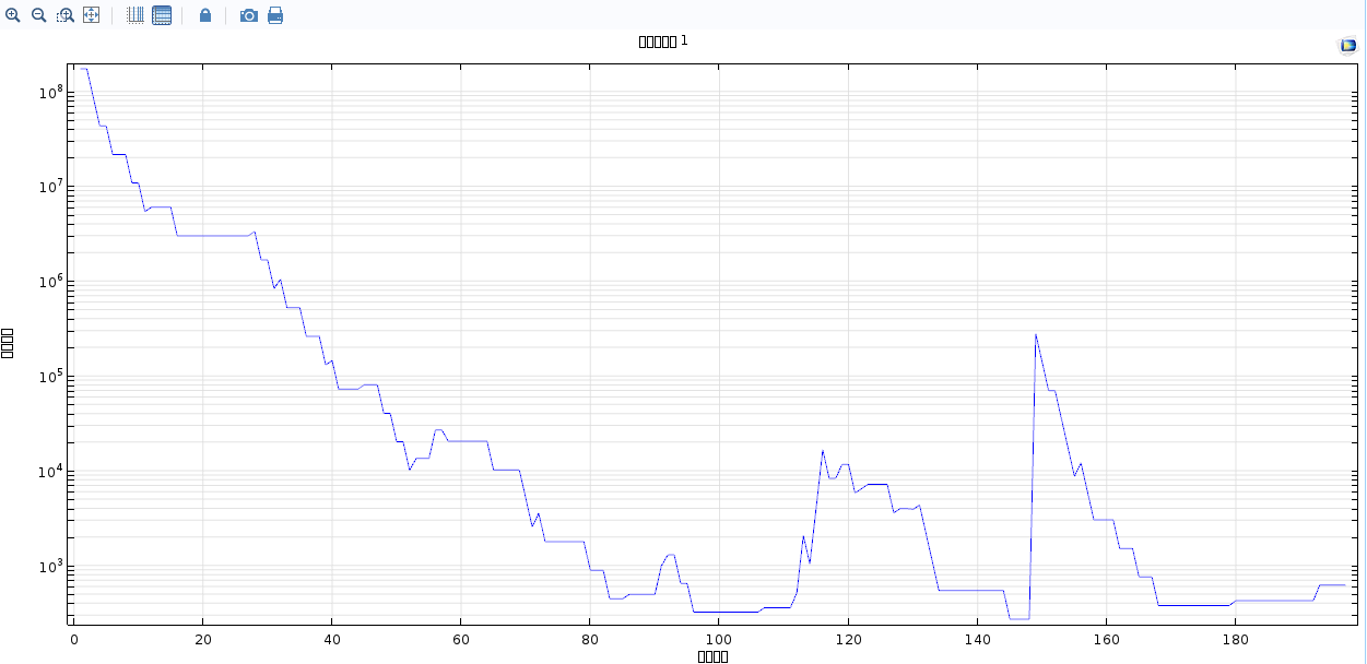

Posted: 1 decade ago 2015/07/30 9:48 JST
My model : the part of core apply BH curve, I feel COMSOL calculate such problems are difficult,could you provide me some advises for the problems
Nirmal Paudel COMSOL Employee
Posted: 1 decade ago 2015/08/12 23:28 JST
To solve a non-linear time dependent problems like this, we do recommend that you modify the Time Dependent solver as suggested in this Knowledge Based Entry:
www.comsol.com/support/knowledgebase/1127/
Best Regards,
Nirmal Paudel
Hi, To solve a non-linear time dependent problems like this, we do recommend that you modify the Time Dependent solver as suggested in this Knowledge Based Entry: http://www.comsol.com/support/knowledgebase/1127/ Best Regards, Nirmal Paudel
