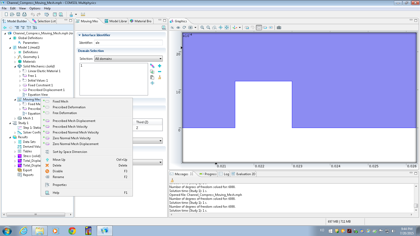

Posted: 1 decade ago 2015/07/20 22:49 GMT-4
Hello Zhoujie,
I found ALE module thanks to your kind explanation.
I have one more question.
To apply ALE, what kind of conditions do I need to use (Please see the attached picture).
Also, do I need to modify the conditions in solid mechanics module?
I really appreciate your help.
Sincerely,
Donghee.
