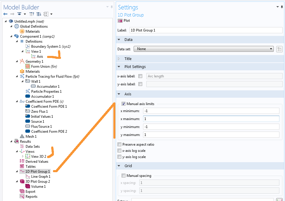

How do we set the axis in comsol 5?
I want to limit the x,y axis in comosl 5? I cant find a way to set the axis manually.
2 Replies Last Post 2015/07/23 9:11 JST
Frank van Gool COMSOL Employee
Posted: 1 decade ago 2015/07/21 16:48 JST
Dear Ash,
that would be under the "view node" in the definitions.
Sometimes this node is present in post processing as well. This happens when the component dimension is different than the plot you are creating (3D component and 2D plot).
For 1D plots you can change the axis limits in the "plot group node".
I hope this helps.
Frank

Posted: 1 decade ago 2015/07/23 9:11 JST
Thank you very much!
it worked
