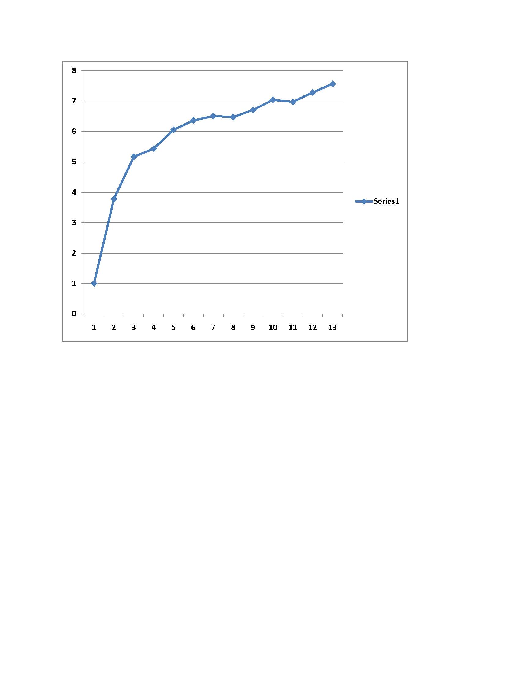

I have a FSI model, and did a steady-state run on my model on a 48 core ~300GB ram, with 500k DOF.
The results are crazy. It seems if I want to do 50 simulations it is the best to run 50 single cores! I have optimized the Pardiso solver to the maximum possible speedup.
Attached are my results.
aka. A real disappointment.

Danial, in your case where you only have a single node, but several cores using the same shared memory, then PARDISO will be best. It will run in parallel on all your cores. We have a similar machine and see much better than your speedup on a problem large enough to fill the memory, but not use any disk swapping.
The latest result I have for distributed parallel processing on a multi-node cluster using both shared memory (per node) and distributed parallel processing we see a speedup of ~ 7.5 across 12 nodes and 96 cores. If we had more cores in our cluster, the speedup would be better because it has not rolled over yet. See attached plot. This cluster uses infiniband to communicate between nodes which helps tremendously. Also, across the nodes, the memory requirements are reduced significantly.
I see your scaling plot now. I am a little confused. You say you have a single-node shared memory machine. However, you also say you have 48 nodes available with a np=1. Perhaps we should be clear on terminology. We do agree that a node is a separate computer. So, if you have 48 nodes, that means you have a cluster with 48 separate computers in it. This is configured in COMSOL using the nn switch. Then, within each node, you have a number of cores on any number of processors all sharing memory. This is configured in COMSOL using the np switch. Is this also your understanding ?
If you are running all those cores on a single node, perhaps your hardware communication bus has saturated. What is the bus speed ?
As you can see from the plot I attached, I get nearly 400% speedup (compared to your 20-30% speedup) on only 8 cores and single node with np=8.
You must be doing something different.

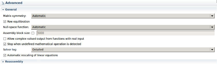

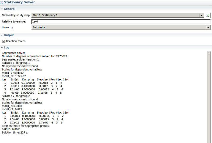

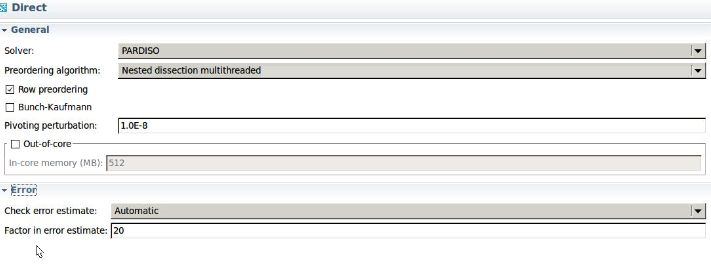

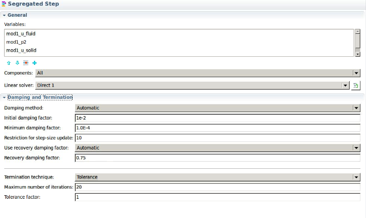

Here is the solver configuration (steady-state) with a sample log file.
Here I am using a segregated solver to add another PDE to solve (variable c), but in my tests above I have a fully coupled solver (without the second PDE) with single F.S.I physics.

Hi James and Danial,
I am also working on the same 48-cores Linux server where Danial did some of the scaling experiments, so I can confirm what he mentioned and also reinforce this with other observations.
I have a rather large 3-D problem (coupled flow with mass transport) that can fill all the memory (~256 Gb), and still the parallel performance is bad.
Just to illustrate what I want to say, I ran a quick (smaller) test a few minutes ago (~8 Gb and -np 8).
The problem is that Pardiso works only part of the time in parallel:
-> Solving the linear system starts with the assembly (~1 min), done fast enough,
-> Then in the matrix factorization step the solver spends ~10 min doing something on 1 core. This was checked with 'htop'. Pardiso evolution counter stays all the time at 0 % in this first phase.
-> Finally, you have the parallelized part working on 8 cores, done in ~3 min. In this stage only, the counter advances from 0% to 100%. Indeed, this second phase of the solution process is gaining speed with more cores, but the first phase is limiting. You can imagine that for the "real" problem this is even more bothering.
Comsol recommends iterative solvers for large 3-D problems.
However, no iterative solver could work on my problem - at all. Neither the Comsol support could give me an answer why is that.
So, if we want to speed-up the parallel solution with direct solvers, we should "get rid" of the first phase of Pardiso. MUMPS does exactly the same. Could it be the preordering?
Cristian
Hi James and Danial, I am also working on the same 48-cores Linux server where Danial did some of the scaling experiments, so I can confirm what he mentioned and also reinforce this with other observations. I have a rather large 3-D problem (coupled flow with mass transport) that can fill all the memory (~256 Gb), and still the parallel performance is bad. Just to illustrate what I want to say, I ran a quick (smaller) test a few minutes ago (~8 Gb and -np 8). The problem is that Pardiso works only part of the time in parallel: -> Solving the linear system starts with the assembly (~1 min), done fast enough, -> Then in the matrix factorization step the solver spends ~10 min doing something on 1 core. This was checked with 'htop'. Pardiso evolution counter stays all the time at 0 % in this first phase. -> Finally, you have the parallelized part working on 8 cores, done in ~3 min. In this stage only, the counter advances from 0% to 100%. Indeed, this second phase of the solution process is gaining speed with more cores, but the first phase is limiting. You can imagine that for the "real" problem this is even more bothering. Comsol recommends iterative solvers for large 3-D problems. However, no iterative solver could work on my problem - at all. Neither the Comsol support could give me an answer why is that. So, if we want to speed-up the parallel solution with direct solvers, we should "get rid" of the first phase of Pardiso. MUMPS does exactly the same. Could it be the preordering? Cristian
Posted: 1 decade ago 2011/02/10 0:09 JST
Yes, I can confirm that the row preordering was the limiting step (because not done in parallel) !
Switching it off improved dramatically the solution time, without compromizing the quality of solution (for my problem, at least).
I will try to show you later also the scaling tests.
Cristian

Posted: 1 decade ago 2011/02/12 20:29 JST
The speed up is problem-dependent indeed, but in my case there was much gain with PARDISO when the preordering was disabled. I attach here my results for scale up experiments done on a 48-core server (2.2 GHz each CPU).
>>> Problem:
- Strongly coupled stationary laminar flow with solute mass transport. That is, the flow and mass transport equations must be solved simultaneously because the concentration affects liquid density, viscosity and (more importantly) the boundary conditions for flow (through osmotic pressure).
- Complex 3-d geometry with inlet, outlet, walls and periodic boundaries.
>>> Solution method:
- The system of equations is non-linear and with the given intial values 4 Newton iterations are needed for each solution.
The total solution time is reported in the attached file (roughly, you have to divide by 4 the time to see how much time one linear solution took)
- I tested on a mesh that leads to 3,057,962 DOFs. In these conditions PARDISO used maximum 80 to 90 Gb RAM.
- The tests are with nested dissection multithreaded preordering and without any preordering. However, I did not notice any improvement by the "multithreded" version. I use Comsol 4.1 update 2.
>>> Results:
- There is a clear improvement in speed when not using the preordering.
- All solutions returned are correct when 1, 4, 8, 16 and 32 cores are used.
However, interestingly, on 48 cores PARDISO did not correctly solve the system (neither with nor without preordering)!
- I attach results (scaling.pdf) for the total time (seconds), speed-up (time np/time 1) and parallel efficiency.
- For many cores, the preordering clearly becomes speed limiting and slows down the calculations 3-4 times!
Cristian

One suggestion to save some additional clock time. You might expand your solver scheme to use the segregated solver, while still using the PARDISO direct solver within each segregated step. You could first separate into two steps: 1) the u-p laminar flow (u,v,w,p) and 2) the remaining variables. This will likely take more iterations, but still save overall cpu/clock time. You may also be able to break down the 2nd step further in some cases.
The other comment is that if COMSOL users have access to a cluster, the memory requirements per node also significantly reduces in addition to the speedup of the solution. I have had at least one case where a problem would not fit on a single node, but could be run on the multi-node cluster. I expect a lot more of that in the future here.
Cristian, Thank you for posting your results. Your results are similar to what I have observed here and are what I might have expected. It appears also that even the shared-memory parallel processing will saturate the bandwidth enough to plateau after enough cores are activated. It appears that you have effectively used the hardware you have to the extent possible. One suggestion to save some additional clock time. You might expand your solver scheme to use the segregated solver, while still using the PARDISO direct solver within each segregated step. You could first separate into two steps: 1) the u-p laminar flow (u,v,w,p) and 2) the remaining variables. This will likely take more iterations, but still save overall cpu/clock time. You may also be able to break down the 2nd step further in some cases. The other comment is that if COMSOL users have access to a cluster, the memory requirements per node also significantly reduces in addition to the speedup of the solution. I have had at least one case where a problem would not fit on a single node, but could be run on the multi-node cluster. I expect a lot more of that in the future here.
Posted: 1 decade ago 2011/02/13 0:38 JST
James, using a segregated solver seemed to me possible initially. However, the problem is too "strongly" coupled (velocity u affects concentration c and c affects u, as well). I tried segregated solution and it did not work at all. It is better for weakly coupled equations (only u=>c, for example).
Anyway, thanks for the suggestion.
I am still trying to make the iterative solvers work, but this is not a problem for this queue...
