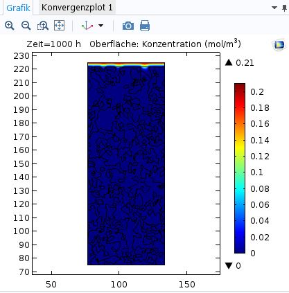

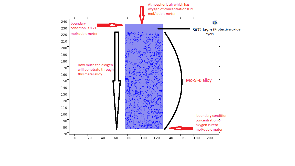

I looked at your model and do not quite understand it. I suppose that in the alloy you have several phases but still only one diffusing species, oxygen. Then you do not need separate tds nodes for each phase, it is sufficient to define the diffusivity of oxygen in them. By variables c2...c7 you probably mean the oxygen concentrations in those phases? Or what are they?
Anyway, diffusion in the solid phase is extremely slow. You have given even values of 1e-50 m²/s in some phases. This means that diffusing 1 µm would take 10^38 s = 3·10^30 years while our universe is ca. 13.8·10^9 years old :) If D = 1e-17 m²/s, in 1000 hours diffusion proceeds ca. 6 µm.
So, what to do: Under one single Transport of Diluted Species (tds) node, define the diffusion coefficient in each domain, nothing else.
BR
Lasse

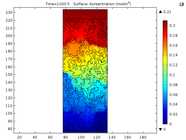

Here my solution. You may correct what I had there wrong.
BR
Lasse
