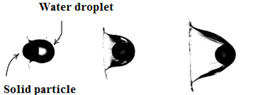

I want to model collision of a particle into a droplet. A ​water droplet is falling by gravity and a solid particle is shot toward that to ​hit the drop.​ Collision outcome is a conic liquid film​ which forms like a liquid skirt for particle​ (please see lamella formation in attached file).
​I need to simulate this phenomenon and compare the results with what I get from experiments. However, I need first to choose the most suitable simulation software capable of considering the followings:
