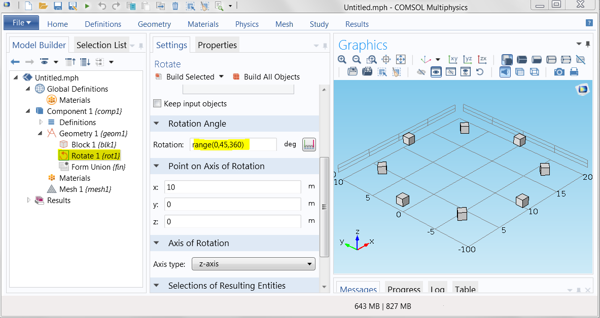

Sven Friedel COMSOL Employee
Posted: 1 decade ago 2015/08/11 18:23 JST
Dear Daniel,
please see my attached file - and - in case you are not running COMSOL 5.1 yet - the screenshot.
Sven
Dear Daniel, please see my attached file - and - in case you are not running COMSOL 5.1 yet - the screenshot. Best regards, Sven
Posted: 1 decade ago 2015/08/12 19:52 JST
Uhhh, how can I have missed this so far?
Thanks a lot!
Daniel
Uhhh, how can I have missed this so far? Thanks a lot! Daniel
