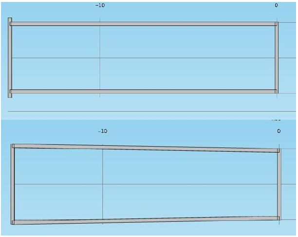

Just wanted to ask hopefully a simple question. Is it possible to link two geometries in my case two beams together through there end points.
I want to basically have a set of blocks (beams) whose shape (length / angle) is determined by the relative position of other beams they may be attached to. Below is a link to a picture which i hope helps explain what I'm after.
yfrog.com/6zcomsolwholej
In the top geometry i have increased the length of the left most vertical beam, however this results in the beam just simply overlapping the top and bottom horizontal beams. What i would like is for it to be possible to change the left most beam length and still have both top and bottom horizontal beam end points attached to the left most vertical beam endpoints, as shown in the bottom geometry. (In that example i had to manually change the rotation).
Basically the two horizontal beams only have the width variable while the length and angle are really determined by the sizing of the two (left and right) vertical beams.
Any help is appreciated.
Regards MF

unfortunately I cannot see your image (normally you can attach jpg files or png files easily to the forum sections, its better than having ecxternal links that dissapear after some time
for me if you make a very long beam, and segment it in smaller parts then you should have a continuity link at the interfaces and they will tip over, one linked to the other, see the lare displacement example of the doc (at leas in 3.5 ;)
Hi unfortunately I cannot see your image (normally you can attach jpg files or png files easily to the forum sections, its better than having ecxternal links that dissapear after some time for me if you make a very long beam, and segment it in smaller parts then you should have a continuity link at the interfaces and they will tip over, one linked to the other, see the lare displacement example of the doc (at leas in 3.5 ;) -- Good luck Ivar

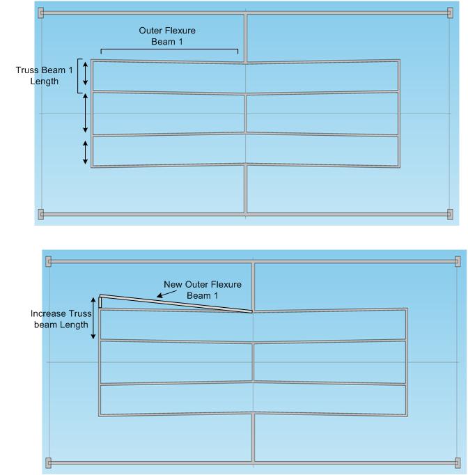

I finally got to the file (have addd it via "snippit" to this reply)
What I do not understand is the way you expect to get the beams to bend by shortening the right vertical side ?
If you say you have two strait horizontal beams and then weld them onto the long one to the left and the shorter one on the right you stress the beams, and all will deform.
You can do this via a few "tricks" such as (traditionally) use a temperature dependace with a anistropic thermperature expansion coefficient on the right vertical beqam, starting with two equally long vertical beams
Or via the contact physics (could be tricky to get to converge) by appying a force to get the beams to the right to come in contact.
or set up the equations to run an optimsation such that the distance of the two beams (if you connect the four over common borders except for the last region) tend to "0"
Hi I finally got to the file (have addd it via "snippit" to this reply) What I do not understand is the way you expect to get the beams to bend by shortening the right vertical side ? If you say you have two strait horizontal beams and then weld them onto the long one to the left and the shorter one on the right you stress the beams, and all will deform. You can do this via a few "tricks" such as (traditionally) use a temperature dependace with a anistropic thermperature expansion coefficient on the right vertical beqam, starting with two equally long vertical beams Or via the contact physics (could be tricky to get to converge) by appying a force to get the beams to the right to come in contact. or set up the equations to run an optimsation such that the distance of the two beams (if you connect the four over common borders except for the last region) tend to "0" -- Good luck Ivar

Hopefully i can be more clear now as i have the full model done, I'm actually trying to optimize a 'Butterfly' MEMS coupling spring, and have therefore parametrized certain parts of the structure.
I wasn't try to move either beam by some force, what i was trying to illustrate was that i can't seem to get two beams to be fixed to each other and when one beams length is increased (creating a new model) this causes the other to alter its shape in accordance.
For example in the picture attached, I have the whole coupling spring structure. Now for example I have on parameterized beam "Truss Beam 1" in which i can alter its length, either increase or decrease.
Now truss beam 1 is attached to the outer flexure beam 1 at its top. If i increase the truss beam length upwards, I want the outer flexure beam end point to still be attached to the truss beam, as in the bottom picture.
Now this obviously results in the outer flexure beam changing its length and angle.
Currently if i change the truss length, i have to change the outer flexure beam length and angle automatically.
If i don't then it basically looks like the picture i gave in the first post where the flexure beam remains the same, while the new longer truss beam pokes out above, as in the second part of the first picture in my first post :)
Is there any way to clamp various points, in my case the beam end points together?
Regards Mike F

Now I believe I catch better what you are looking for, the issue is then how to make a clean geometry (as you start with a model without stress, deformations is second step).
Well I would have done it in SolidWorks CAD (parametrised via the "Equations") and linked it via Livelink (in V4) such that I could rerun the hole with the new geometry.
In 3.5 one could try to make the geoemtry via matlab, should work but is (in my view) far more tedious. Then not to forget to make an union or composite entity, and remove unwanted internal boundaries.
One trick if you work with very different thickness of beams and fixed regions (not really your case just there) I mostly split my thin beams in the middle to force a more detailed mesh and at least two elements per beam width, and I cut the beam with an interiour boundary slightly inside the fixed side, such to force high mesh density at the attachments.
Anyhow you have the issue of stress concetration (numerical as well as real) with right edge flexure beams particular of mems size items (if you use wet-etching or other techniques) here its difficult to be fully representative

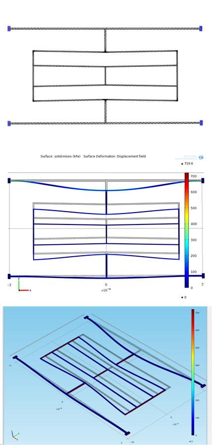

Well, I think i managed to get something working :D
This is a displacement of the spring of -100 N along y axis, using a coarse mesh.
For some reason in COMSOL it shows up wrong, the only colours are dark blue over the top plane, and then the maximum stress red along the side plane as somewhat shown in the attached picture.
Still exporting it seems to give the correct von mises stress picture, i hope :).
Regards Mike

a few comments:
1) with respect to stress, do expect very high values in the corners where you have stress concetration, there you would probably also get numerical issues so one can never 100% trust thos values, very locally. You can still plot the overall stress distribution by detecting these spikes and clip the color range. But still, what is the true value in these corner ? >>1GPa is not really survivable for your system, be aware.
Your issue with the colors could be, try a 3D plot and see if you do not have somevery "high" spikes (orders of magnitude" then tweak the color range.
2) In general try to avoid point loads, in 2D it corresponds to edge loads so could be considered, but the best is surface loads over at least a few elements (but you need to normalise your force to pressure over the load surface (can be done internally by the load options in V4, must be done manually ie.e integration coupling variables in v3.5a
3) check carefully your meshing, in V4 you can run your model with a parameter to increase the meshing, run for n, 2*n 4*n anf if possible 8*n elements just to see the sensitivity of your model to the expected results (again singular points may give you some surprises, think over what kin of criteria to use, displacement, stress, total energy ...
4) I normally say 3-4 elements across a beam as absolute minimum, therefore often starting in 2D helps to set up the model because its so much faster, using symmetry is also a nice way around, but note that for eigenmodes you must combine symmetric and antisymmetric BC's to get all modes out, and often the loads you apply are not really symmetric, hence you must use the full model.
Unfortunately COMSOL V4 does not (yet ?) have the facility to make mesh mirroring i.e. you have a symmetric geometry defined, you mesh only 1/2 or 1/4 or even less and then ask the mesher to distribute the mesh symmetrically on the rest of the geometry.
You could ask why, but often for complex geometries you have to do a lot of mesh fiddeling, it divides the work by 2, 4 8 or even more, this is important when you need to sell the purchase and mainetnance costs of a software to your boss, and then when you want to do very precise analysis (opto-mechanics or interferometry) the assymetric meshing you get by full "free-mesh" is enough to give large errors compared to the scale you are looking for, all this is probably not fully relevant for you as is, but if you go into opto-mems it will be.
5) check your forces, take the reaction forces on the fixed points and compare them to the load forces should be the same.
This is another slight weakness in COMSOL structural, it does NOT propose any simple validation/verification scripts, such as comparing the reaction forces to external forces, the total stress energy to the input energy ... But I'm sure these things will come, one could imagine a series of scripts to do this. Typically a good "student job" unfortunately I have none at hand ;)
