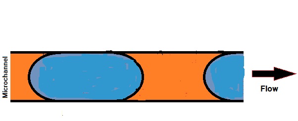

I would like to generate a slug flow in a micro-channel (as shown in the attached image). I have started my model by using the Droplet Breakup Model but I noticed that the droplets started to dissolve as the move downstream! How can I overcome this problem please. Also, is there a method to generate slug flow without mixing two fluids? I mean depending on the boundary conditions of a single channel?
