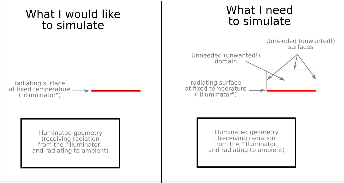

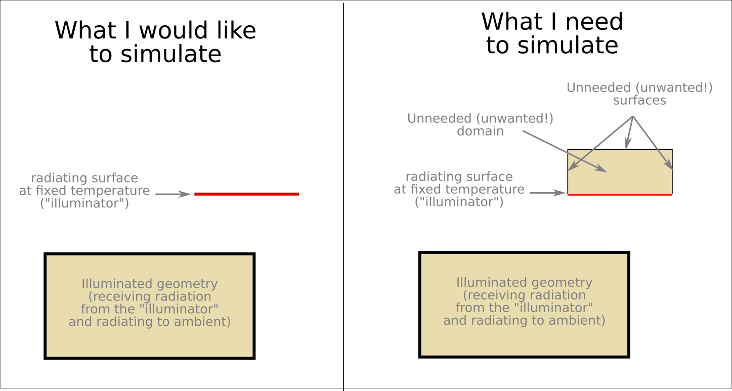

Rather than a COMSOL model, let me attach a picture illustrating the problem using an hypothetical simplified 2D model. Left is what I would like to obtain. Right is what I need to now, since I don't know how to include a radiating surface without it being part of a closed domain.

Now again, the problem is: I have my domain representing the physical objects that are illuminated. I want to define a surface somewhere, at a fixed T>Tamb, that "illuminates" my object.
- If I create a domain (completely exterior to my illuminated objects, not "containing" them), then I can define one of its surfaces (looking towards the illuminated) as "emitting", and all works fine (see right panel on attached figure, in which I have colored the domain to make them easier to distinguish). However, I have the problem of having to include the additional domain, and its non-radiating faces, in the simulation.
- If I create just a surface, that would be ideal (left panel in the attached figure). Except, I do not know how to tell COMSOL to use that surface as a radiation source, since COMSOL only allows me to include domains, and not surfaces, in the "heat conduction" physics interface.

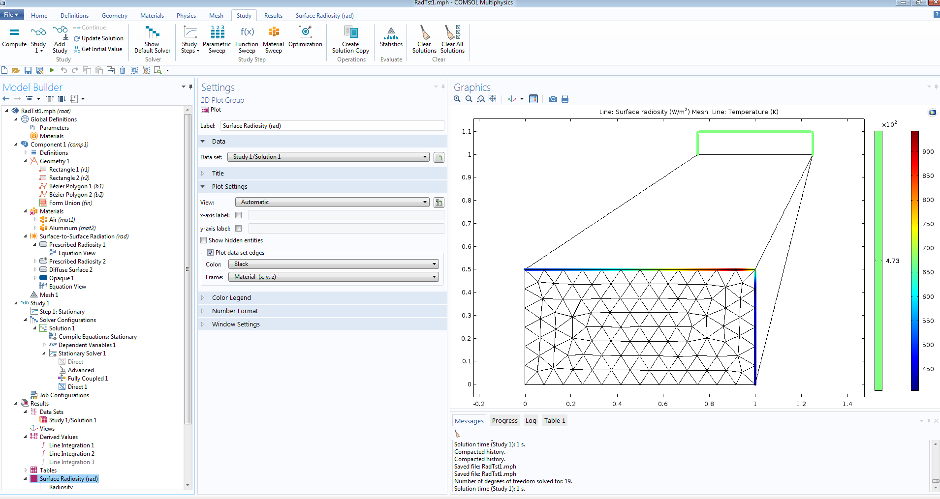

Probably what puzzles me is that what you are asking for is, for me, what the "Surface to Surface Radiation" module is exactly doing (or allows you to do)
I have tried to regenerate your problem in the model below in v5.1.0.180
check carefully the doc too, I see now that COMSOL has nicely improved the capabilities since I used it last :)
Here I'm not solving for an T, I impose them you need to add the HT for that (or use the full HT+Rad case
