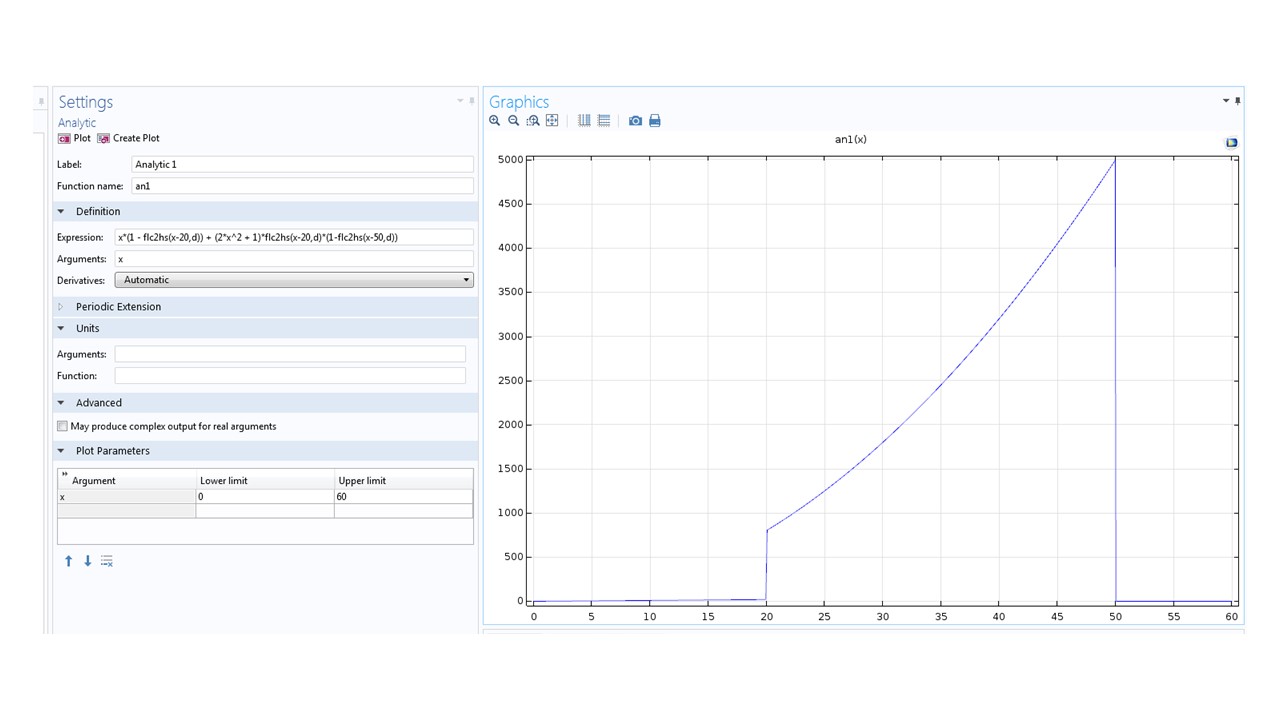

I'm trying to define an analytic function in the global definition that has multiple definitions over different range. For example, the expression is x, when 0<x<=20; the expression is 2x^2+1 when 20<x<=50, so on. How should I combine them into one analytic function? Or should I just define a bunch of them then somehow use all of them later (in the material properties for example)?
Any help is much appreciated! Thanks!
