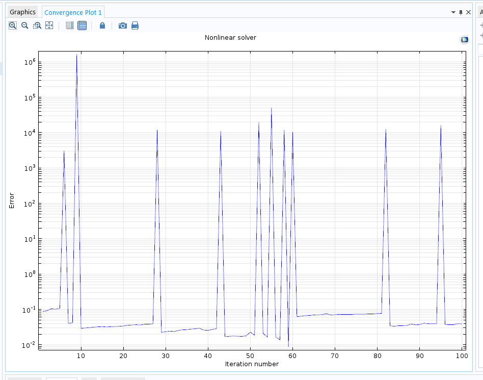

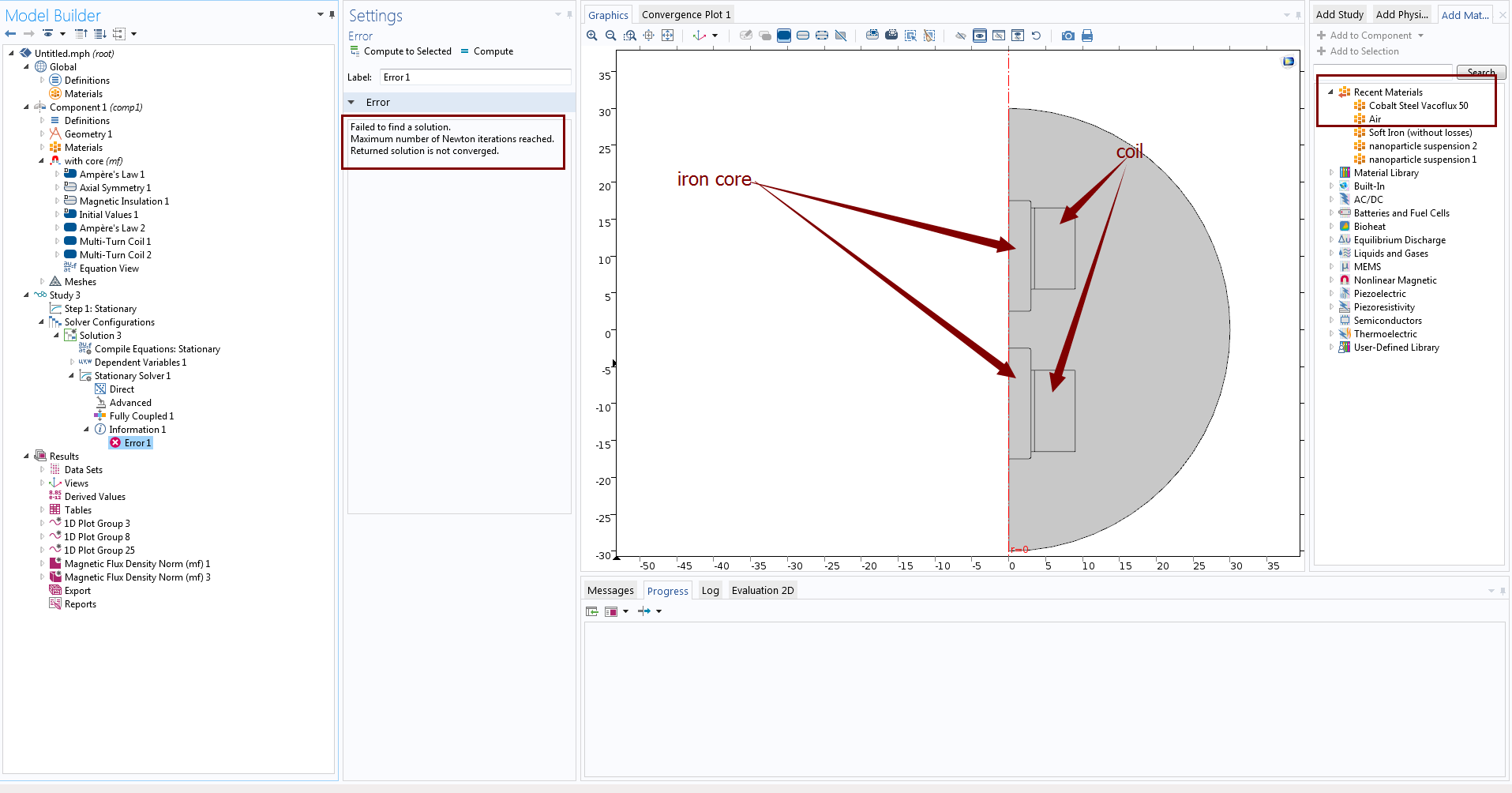

I built 2d axisymmetric model, which consist two iron cores(Cobalt steel vacoflux 50) and two coils(with 5A, 5000turns), I applied HB curve to iron cores. I want to see the magnetic field.
I used stationary solver , it is shown that "Failed to find a solution.Maximum number of Newton iterations reached. Returned solution is not converged."
I tried to refine the mesh, the results were still not converged.
what should do to make the model computable?

Hi Xingming,
There could be several issue issues in the model that is preventing the model to converge.
If you are using a non-linear BH Curve or HB Curve, make sure that you have the first data point (0,0) in the table. Also, the following Knowledge Based Entry might be helpful here to tune the nonlinear solver.
www.comsol.com/support/knowledgebase/1127/
Note: the solver settings discussed here are for time dependent nonlinear solver, but it is still applicable for stationary nonlinear solver as well.
Hope this will be useful.
