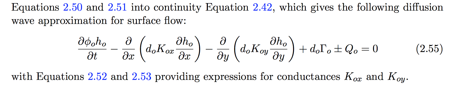

I want to write equation that I attached here, and I wrote it inside the comsol but I am not sure if this is the correct form of writing.
Explanation about equation: d0= depth of flow h0=water surface elevation K0(x,y)= surface conductance in x and y direction.
