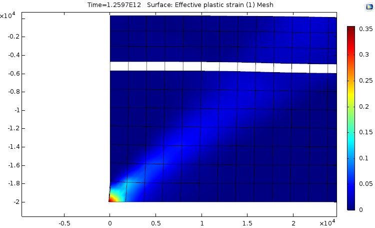

My model is running well until a certain time, when plastic deformation just blows up at the left bottom corner. My first guess to explain this problem is the conflict between the left BC(fixed in y and x ) and bottom BC (fixed in y but moving at with a velocity of -0.8 mm/yr in x). Indeed, the left bottom node will move at the speed of 0.8 mm/yr toward the left, whereas the node just above is completely fixed in both direction. This implies that the element in between those two nodes is highly deformed and gives crazy plastic deformation to finally stop the model.
I was wondering what i should do to get around this problem at the left bottom corner, in order to allow my model to finish the computation (or at least, run for a bit longer)?

I should have precised that i tried with a rolling BC on the left wall, but it didn´t solve the problem at the bottom left corner. The problem comes from the fact that the left wall is fixed in X and the bottom boundary is forced to move in X. The element at the left bottom corner is then highly deformed (see picture attached) and plastic deformation just blows up. In my opinion (and after some test), allowing the left wall to move in Y cannot solve the problem at this location.

but from your image, if the black lines are your mesh then its normal you have a singularity particularly in quad mesh in such a sharp corner, it's "mathematic". And its all within your single mes element I see, also "normal"
The easiest is to simply ignore that corner or exclude it, there are different ways, one is to make a small box, of the size of your current mesh just there, mesh it somewhat finer and then exclude it from the plots, or play on the max stress rulers of the plots (tedious though)
