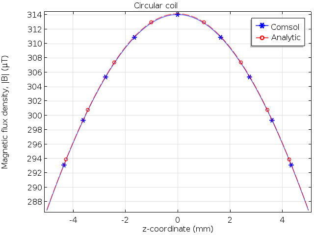

Alessandro,
Attached is model file with comparison to analytic solution.
Sergei
Alessandro, Attached is model file with comparison to analytic solution. Regards, Sergei
