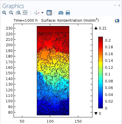

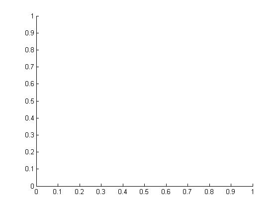

I have saved the mph file and then I wrote command in Matlab script. But it does not show the plot rather it shows error and a blank graph (Please see attachment: Matlab_figure). But the actual plot of comsol looks like the attachment 'Comsol_figure'.
The errors are given below:
Error using strcmp
Too many input arguments
Error in mphplot/1_getPT (line 485 )
Error in mphplot/geomedgeplot (line 289)
Error in mphplot (line 223)
I used only mphplot(model, 'pg1') command. I just want to render the plot to Matlab. Do you have any suggestion why I have this kind of errors ? Thanks in advance.
This is a bug that has been fixed in our latest update, which you can get here:
www.comsol.com/product-update/5.1
Error using strcmp
Lars Gregersen
Comsol Denmark

Hi Lars
i have the latest and greatest comsol version
#Version properties.
ver.build=234
ver.major=0
ver.name=COMSOL 5.1
but still i get a error when using mphplot
% create a 3D plot group
pg = model.result.create('pg','PlotGroup3D');
%create a surface plot
surf = pg.feature.create('surf', 'Surface');
surf.set('expr', 'T');
% display the plot group
mphplot(model , 'pg')
the error is the following:
Error using strcmp
Too many input arguments.
Error in mphplot/l_getPT (line 485)
We have created a Knowledge Base entry with an attached mphplot.p file that should solve the problem. Let us know if you are still experiencing issues.
www.comsol.com/support/knowledgebase/1214/
Jesper Been
COMSOL Denmark
I've replaced the .p file, but mphplot still doesn't work. It doesn't show error message any more, but no plot is displayed either.
Hi there,
There might be other issues with that plot then. I suggest you send a repeat model to support.
