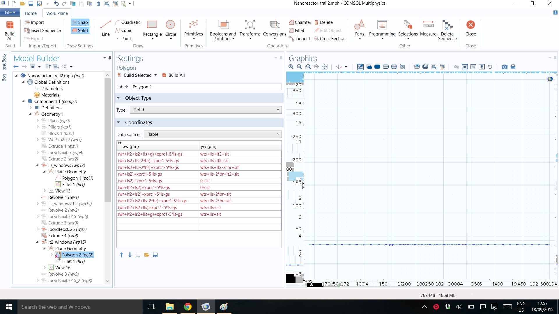

Comsol is not detecting the variables while a building a polygon geometry in a work plane
Dear comsol,

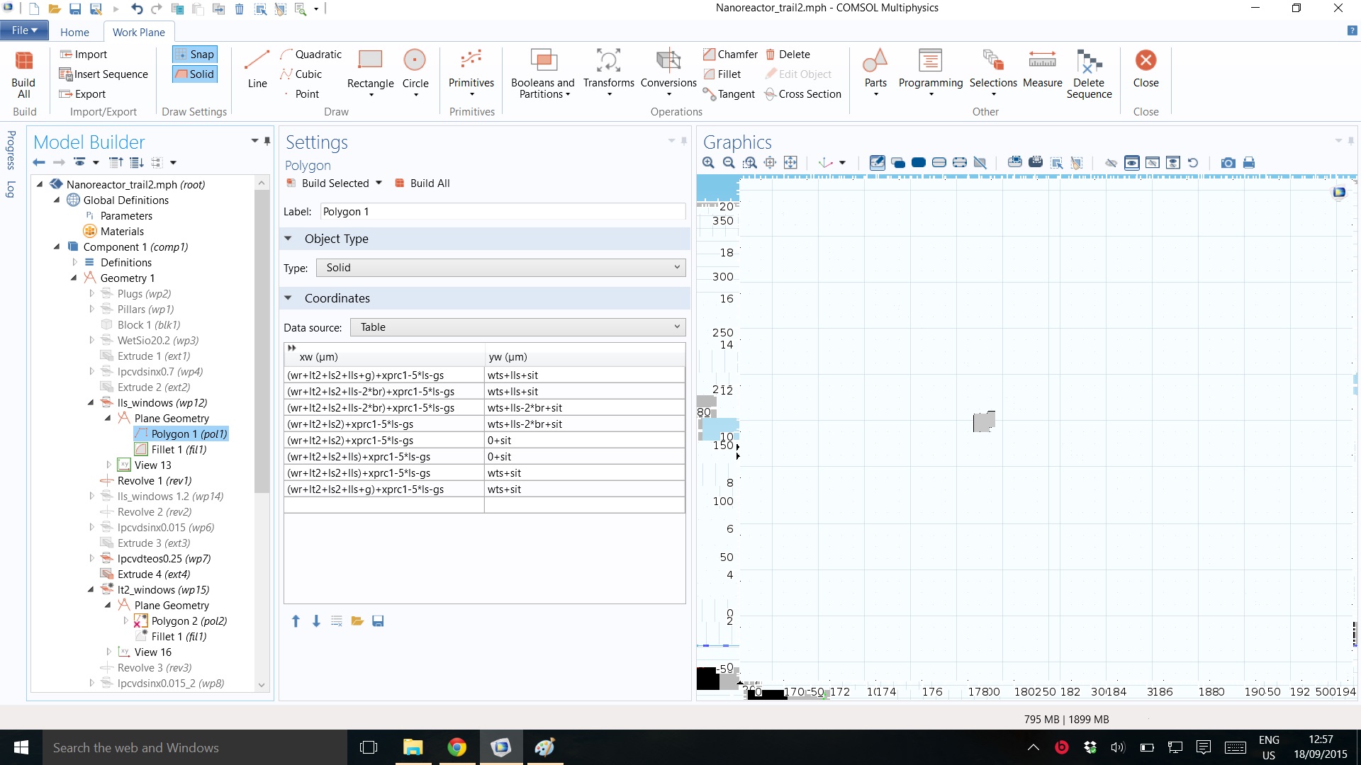

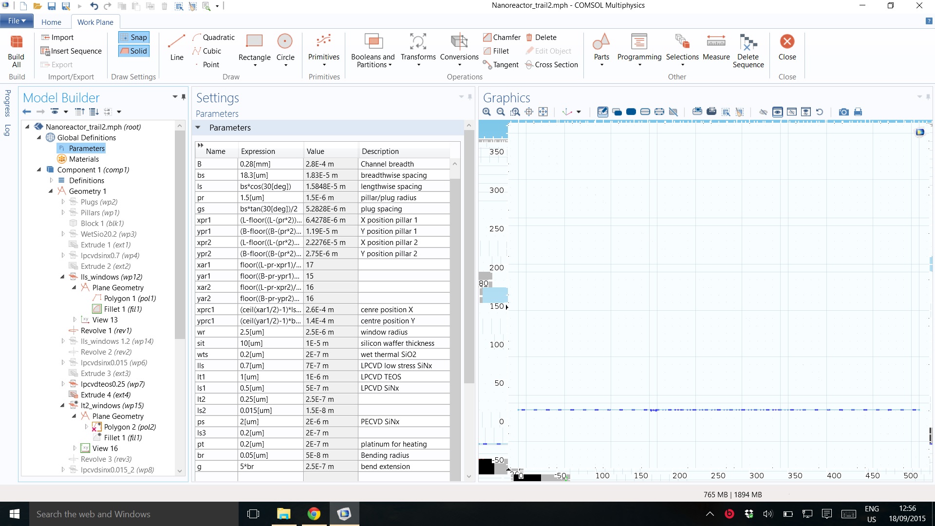

I specified all the required parameters under definitions. I builded many other structures using those parameters. Now i'm trying to build a polygon in a work plane (I previously a polygon using those parameters in another work plane). I don't have a clue why it is not working this time. for further understanding pls ref to the screenshots attached.
Thanks in advance
Regards, Pradeep
