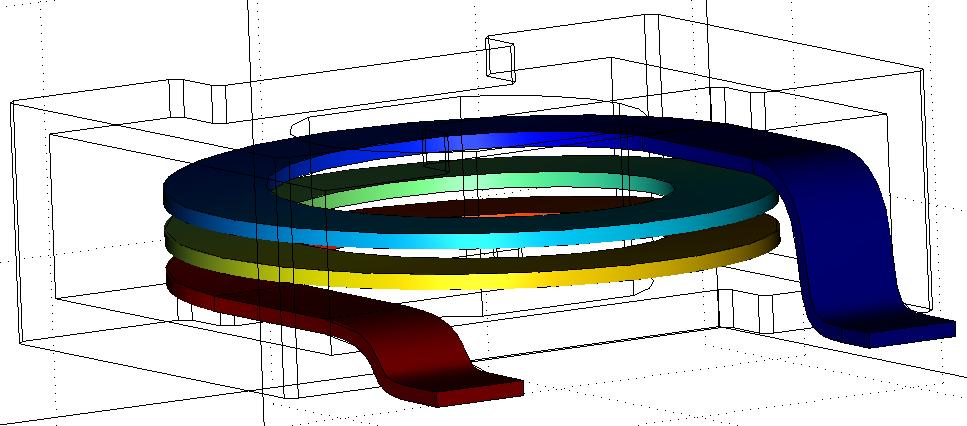

I would like to draw the winding of the power inductor model in AC/DC Module, COMSOL 3.5a. This example is not explained from the scratch, you must import the geometry. I need that kind of winding to try it on mi own designs. I can do an helix but this winding has a rectangular cross-section and its a bit difficult. Could anyone give me a hand on that? If you know how to do it with COMSOL 4.0 it can be a solution to my problem too, because I think you can export the geometry in the way that v.3.5a can read it. I don't have version 4.0a yet, still waiting for it.

I attach a screenshot of the winding that I want to model. It's like a circular helix, but with rectangular cross section. Actually, I would like to model it as an square-shaped helix instead of circular, but I think that this is easier to achieve as a starting point.

indeed I was thinking of a "square" where you have the spiral. Then you should try the extrude with torsion features in the CAD or the 2D to 3D mesh extrude, you may have better luck there
