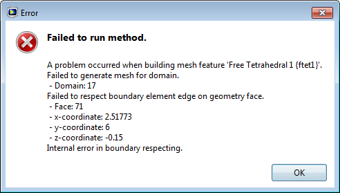

I am working on creating a routine in java, which will attempt to create a mesh for each instance of a parameter defined within a sweep before the solution is computed. Last thing we want to experience is a crash of some job only due to something we could have checked earlier, don't we?

I am sending an attachment that shows a typical message after builing mesh has failed.

Alright, for now I have specified "ExceptionType" as just an "Exception". The code compiles and the situation is fine, as long as I don't need to refer to any specifics of the error...
