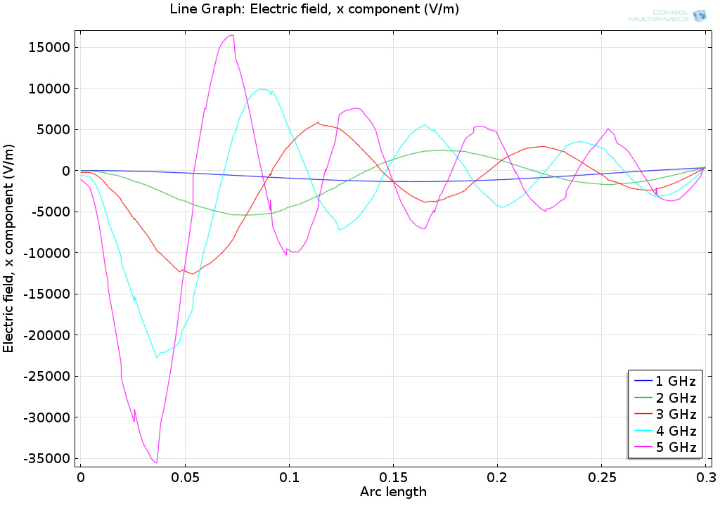

Hi everyone, I reached a good result for a hertzian dipole simulation and plotted the components along a 3D line, and I figured out that the results' graph shows the real part of the component.
I need to plot the fase variation along the planes, but I didn't found a expression from a complex form of the result. I put the Solver to split the real and imaginary part but the result don't converge.

For the phase of Ex, consider plotting atan2(imag(emw.Ex),real(emw.Ex))
Posted: 1 decade ago 2015/10/09 7:47 GMT-4
Piaga,
Also, you can use built-in function arg() to plot the phase of the complex-valued field: arg(emw.Ex).
Sergei
Piaga, Also, you can use built-in function arg() to plot the phase of the complex-valued field: arg(emw.Ex). Regards, Sergei
