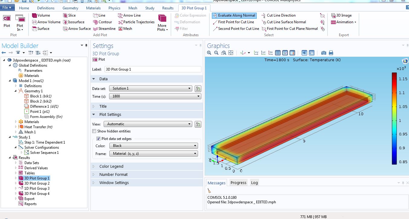

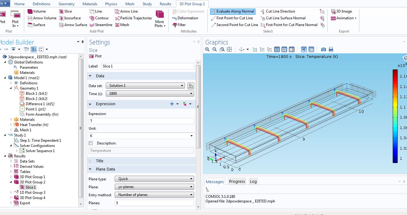

Hi I tried to edit your file but I could not send it to you. I can send you the edited file to your email if you wish. Attached are the pictures of the solution of the edited file.
Joel
William, Hi I tried to edit your file but I could not send it to you. I can send you the edited file to your email if you wish. Attached are the pictures of the solution of the edited file. Joel
