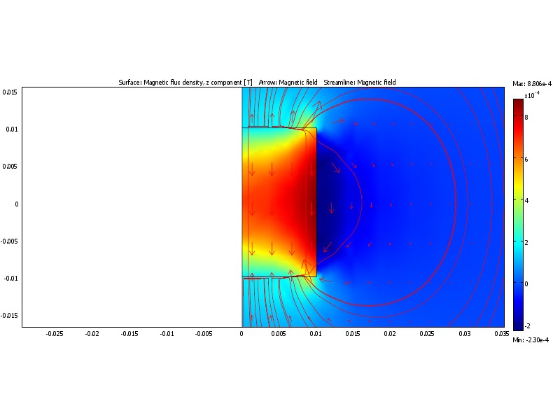

1. The magnetic lines should be closed paths, but inside the magnet the direction is the opposite to the direction outside the magnet. Is that normal in COMSOL? By the way, why if I set the residual magnetism of the permanent magnet, Br, to 1T, the maximum value of magnetic field is not 1 anywhere?

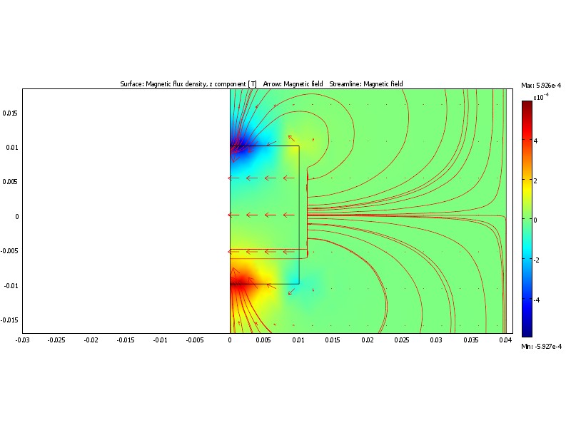

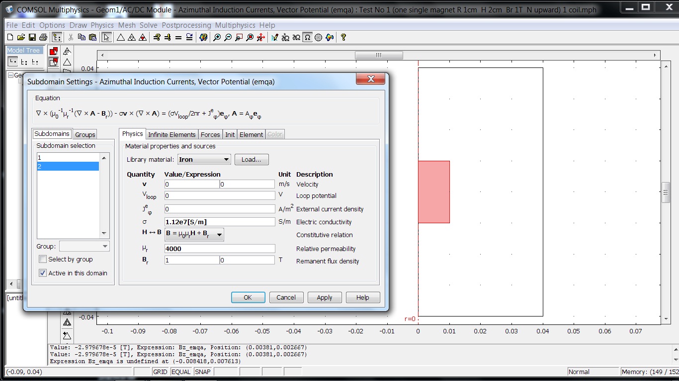

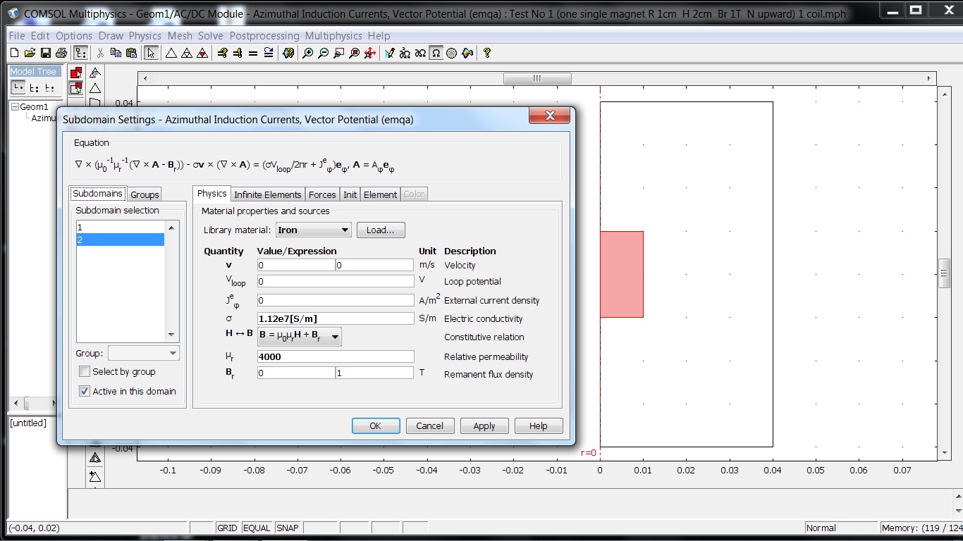

2. I'm testing with a value of 1T for residual magnetism in the permanent magnet. I think that's a value, not an expression, but if I write 1 in the value field the magnetic field seems to be parallel to "r" (horizontal axis) and if I write 1 in the "value" field, the magnetic field seems to be parallel to "z" vertical axis. Can you tell me how should I deal with this? Is there any part in COMSOL manual where it is specified how COMSOL assigns values for this? What if a want to set the magnetic field with 45 degrees respect to the r axis? or set a magnetic field in a magnet where the upper half is north pole, and the lower half is south pole?

first of all note the naming Br is the "remananet B" and not the "r" component of the B field ! so the first block of Br is the "r" radial component, and the second is the "z" component (in 2D axi)
2nd if you have a magnet you should set "M" and not "Br" to the value of the "Magnetisation" of your magnet, change the formula by selecting it in the respecive field on the window, and then update M either along r or Z (or both vector components if you want it at an angle such as 45°)
