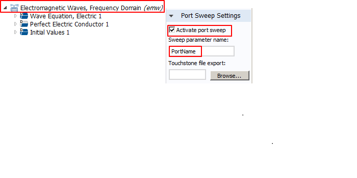

Cris,
Yes, there is an automatic way to calculate full matrix of S-parameters. In the Settings window for the “Electromagnetic Waves, Frequency Domain (emw) root node, there is section “Port Sweep Settings” where you can check “Activate port sweep” option, as shown in the attached image. This will allow you to perform sweep over the one active port at a time and extract full S-matrix using Global evaluation node.
Sergei
Cris, Yes, there is an automatic way to calculate full matrix of S-parameters. In the Settings window for the “Electromagnetic Waves, Frequency Domain (emw) root node, there is section “Port Sweep Settings” where you can check “Activate port sweep” option, as shown in the attached image. This will allow you to perform sweep over the one active port at a time and extract full S-matrix using Global evaluation node. Regards, Sergei

Posted: 9 years ago 2016/05/20 8:54 GMT-4
HI! I am designing switch with three port structure. PORT 1 as input, PORT 2 Output, and PORT 3 as Control port. I am getting all S-parameters using "SWEEP PORT" command for ON STATE, but not for OFF State.. [means when PORT 1,3 are ON and PORT 2 is OFF]...
Is it possible to extract all S-parameters for 3 port device when 2 ports are excited and one is OFF..
Thanks,
HI! I am designing switch with three port structure. PORT 1 as input, PORT 2 Output, and PORT 3 as Control port. I am getting all S-parameters using "SWEEP PORT" command for ON STATE, but not for OFF State.. [means when PORT 1,3 are ON and PORT 2 is OFF]... Is it possible to extract all S-parameters for 3 port device when 2 ports are excited and one is OFF.. Thanks,
Posted: 9 years ago 2016/05/20 11:55 GMT-4
Yes,
you can disable the "activate port sweep" , and select two ports on manually.
if you want to do a sweep, you can turn all three port on, and set a variable for the "Port input power", when the power is zero, it is actually at off state. then sweep the varaible to turn off the port one by one.
Hope it works.
Cris
Yes, you can disable the "activate port sweep" , and select two ports on manually. if you want to do a sweep, you can turn all three port on, and set a variable for the "Port input power", when the power is zero, it is actually at off state. then sweep the varaible to turn off the port one by one. Hope it works. Cris
