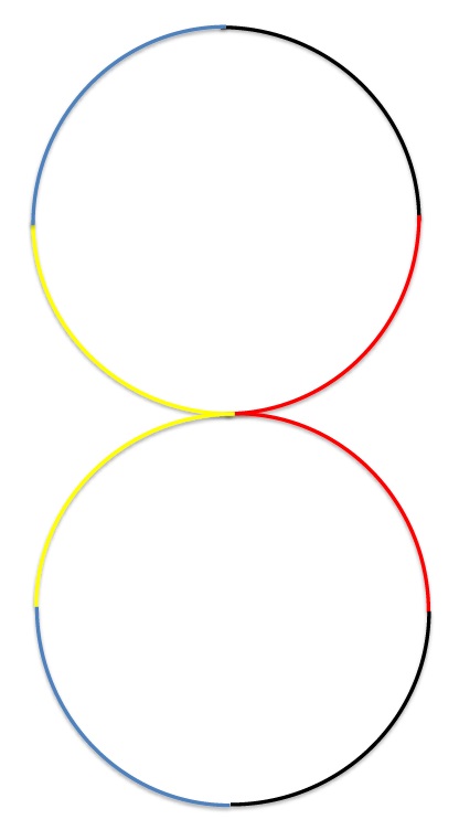

I am trying to simulate the magnetic fields around the overhead transmission line considering the influence of the ground. In order to consider the hole region, I am using a mapping technique that maps an unbounded 2D space into a unit circle, in this case a point p(x,y) will be mapped to a unique point P(u,v). Considering that the ground surface is given at y = 0, I am mapping the space above the ground (y > 0) to a unit circle with center at (u = 0, v = 1), and the space below the ground (y < 0) to a unit circle with center at (u = 0, v = -1).
As you can see, the boundaries of both circles in the mapped domain are representing the ground surface, in other words, the boundary of the upper circle and the boundary of the lower circle are representing the same boundary (ground surface). For that reason, I want to make sure that I will have some kind of continuity with respect to the fields going through the boundaries. For example, if I have magnetic field going through the lower left side of the upper circle, then I should have a magnetic field coming out from the upper left side of the lower circle. I have attached a simple (silly) figure to help understanding how the upper and lower boundaries are related. In this figure, the boundaries with the same color are representing the same portion of the ground surface.
So, my question is, what condition should I use in these boundaries to ensure that they are the same boundary, even though these boundaries are physically separated.
