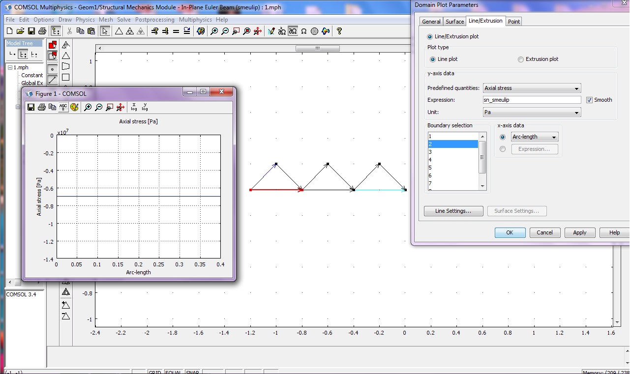

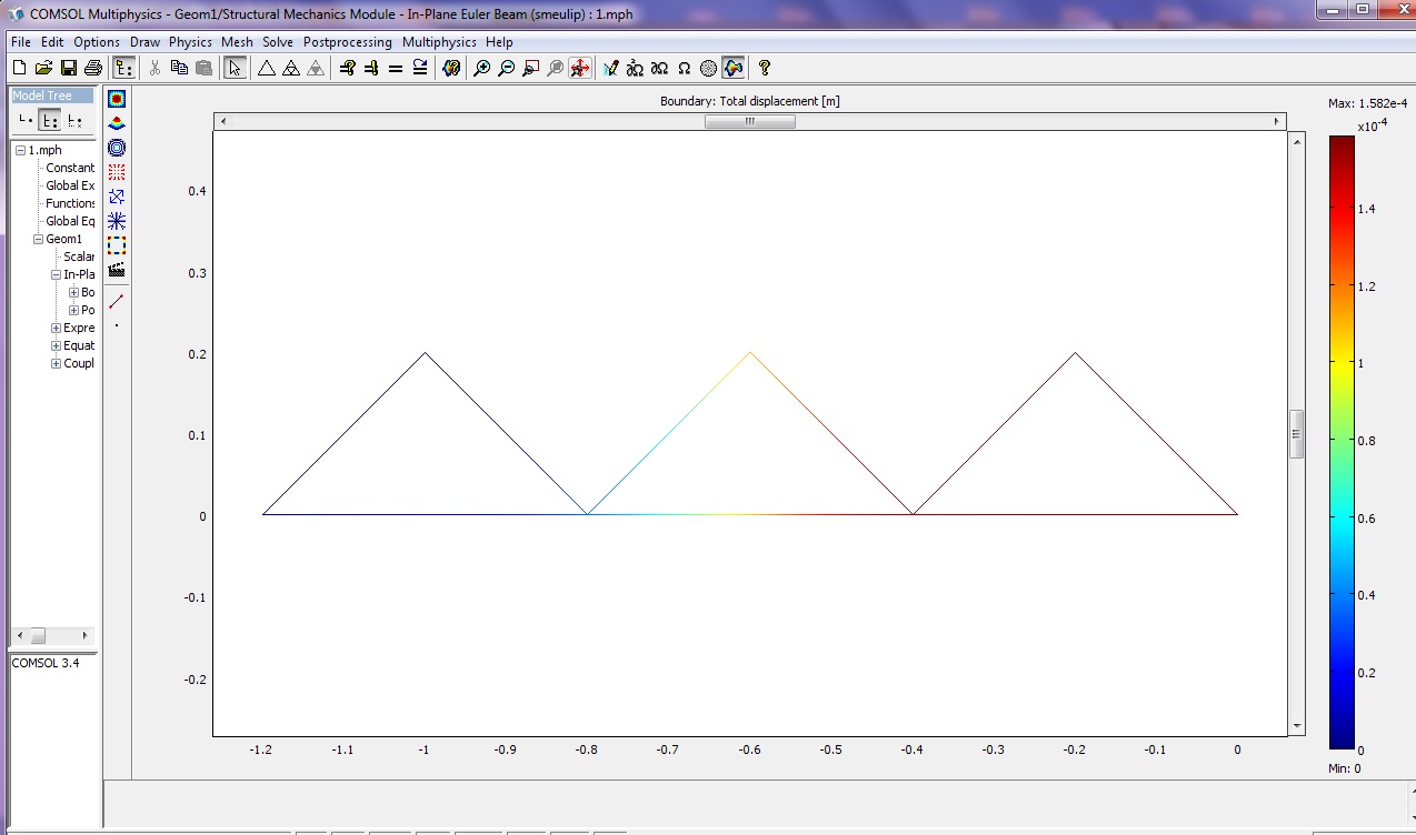

I am a new user of COMSOL, I have this model (under the message!) how could I measure the stress in every point Or is there any way to take this DATA as fife *.txt?

thank you for you reply,
Actually I find something but I am not sure about it!
I go to the menu :
postprocessing ->Domain Plot Parameter->Line/Extrusion then from the field Predefined quantities
I select the (Axial Stress) and if I select any Boundary Ex:2 and press Apply button a plot will appear (see the attaches file)
also I can save this value like .txt file. Is this the stress value!?
thank you for you reply, Actually I find something but I am not sure about it! I go to the menu : postprocessing ->Domain Plot Parameter->Line/Extrusion then from the field Predefined quantities I select the (Axial Stress) and if I select any Boundary Ex:2 and press Apply button a plot will appear (see the attaches file) also I can save this value like .txt file. Is this the stress value!?
Posted: 1 decade ago 2010/09/12 1:50 JST
that is correct, you can get a text file like that, you need to assemble it in several steps though, not very handy but for a one-shot probably quicker than to learn all the matlab stuff, if you do not use it often (note, if you are to switch to COMSOL V4 soon, I would say: do not use to much time on V3.5 and matlab interface, as things has changed quite alot, and you would need to "re-learn" a lot, I'm stuck in that situation).
Still V4 is cleaner and allows even more than 3.5
Hi that is correct, you can get a text file like that, you need to assemble it in several steps though, not very handy but for a one-shot probably quicker than to learn all the matlab stuff, if you do not use it often (note, if you are to switch to COMSOL V4 soon, I would say: do not use to much time on V3.5 and matlab interface, as things has changed quite alot, and you would need to "re-learn" a lot, I'm stuck in that situation). Still V4 is cleaner and allows even more than 3.5 -- Good luck Ivar
