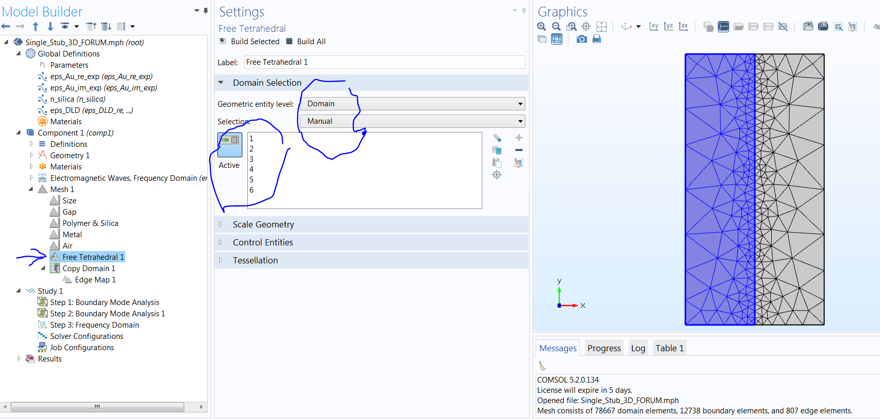

it works for me (ok in te 5.2 beta but I'm sure its also valid for the previous versions.
What you had missed is that your default Free Tetrahedral was meshing all "Remaining" domains. Then the copy does not work because the destination is already meshed :)

Hey Ivar
Thank you very much. You really solved the problem!
From the error message I got, I didn't expect it to be the problem of meshing "too much". I'd thought of a wrong number of faces from the geometry or similar...
