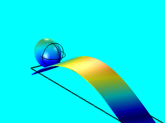

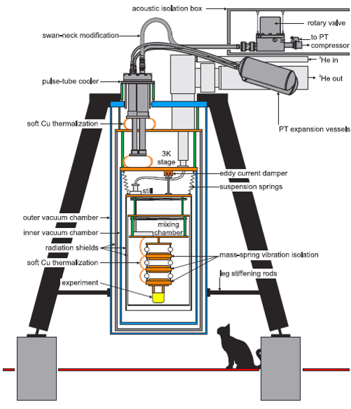

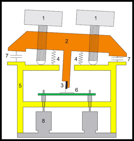

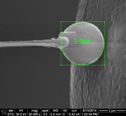

I attached some pictures which shows you some details of the actual set-up. The cantilever is attached to a cantilever holder (number 3 in picture), and the holder is attached to a piezo element. As you can see, the system is build such that we have very little dissipation, that's why we can achieve Q-values of 30k.
I also attached an electron microscopy picture of the magnet, assuming that I have a perfect sphere is a good enough approximation.
I measured the driving force of the piezo, so I could as you suggest implement this first using a time-varying boundary load.
Now a silly question since I'm not an expert on the field of damping, but can't I just omit everything and just tell Comsol that I have a Q-value of 30k? If I then tell Comsol with what force I am driving, then I hoped that Comsol could tell me what the position (displacement in um) is of my magnet at any time. during the oscillations. Or is this naive and completely wrong?

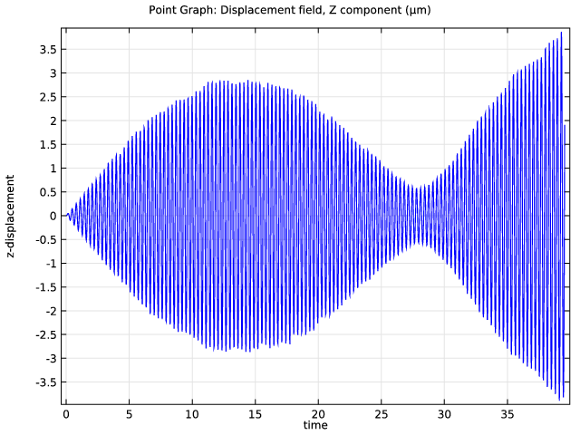

I managed to implement the driving and I get displacements which are realistic (order micro meters). I also see resonance. To build a realistic model however, I am now convinced that I indeed need to include the physics of damping. I studied the articles you sent me. Rayleigh damping is used to model proportional/modal damping. However, I assume that I'm in the weak damping regime (eigenmodes are approximately equal to the undamped eigenmodes). This vision is also supported by experiment, since the eigenfrequencies I found are all within 10% of the eigenfrequencies computed with Comsol. Still, I think that I cannot just ignore damping, driving at resonance would probably mean that without damping the displacement of my cantilever would be "infinite" if I exclude damping.
So if I follow your advise, I will ignore Q since I do my studies in the time dependent module. There, I will find and tune alpha and beta such that we have a flat damping between f1 and f2.

Posted: 10 years ago 2015/11/15 14:18 GMT-5
Dear Ivar,
Thank you for your advice once again. I’ve read the literature about Rayleigh damping and I studied the Structural Mechanics Module. After several studies, I still did not achieved one proper simulation. I tried the following:
(i) Eigen frequency study: I did the study and found my resonance frequencies, which are within 10% of the measured resonance frequencies. So this works so far.
(ii) Time domain analysis: I implemented a time varying point load (#) located at the top of my spherical magnet. The boundary on the other side was kept fixed. I also implemented Rayleigh damping (##). I looked at the z-displacement of the same point and I saw resonance occurring, see attached graph. Unfortunately, the z-displacement decreases at some point and increases later again, a ‘beat pattern’ becomes visible. This could indicate that I’m not driving at resonance, but close to resonance. Though, if you look at the beat pattern, it becomes clear that if this explanation is valid, I’m 200 Hz off resonance… Next to this problem, I also don’t know when I am in steady state. This wouldn’t be a problem to sort out if these calculations wouldn’t cost my computer hours to calculate.
(iii) Frequency domain analysis: I was inspired by Comsol’s example hpc.mtech.edu/comsol/pdf/Structural_Mechanics_Module/StructuralMechanicsModelLibraryManual.pdf, page 3. Using this method, I will get the steady state displacements right away. As a toy model, I played with this for a simple cantilever without a magnet and different dimensions. This worked perfectly, I got a nice displacement vs frequency plot. Unfortunately, when I applied the same strategy to my real model, I got the error ‘Failed to find a solution for the initial parameter. The relative residual (0.55) is greater than the relative tolerance. Returned solution is not converged.’
For the latter study, I used the same Rayleigh damping, and this time a load of 0.1 N/m (corresponds to a point force used earlier, spread over the cantilever’s surface).
Do you have any suggestions what is going wrong here? I’ve also included my Comsol file without the results, perhaps you can spot some classic mistakes I’m making. Perhaps I must indeed not set alpha to 0 but set alpha and beta such that I will get the flat Q.
The point is, that I want to study a specific higher mode and I just want to know how the displacement of the magnet is, that’s all, but it turns out to be a tough simulation…
I hope you can help me a bit further with this problem! Thank you very much in advance :-)

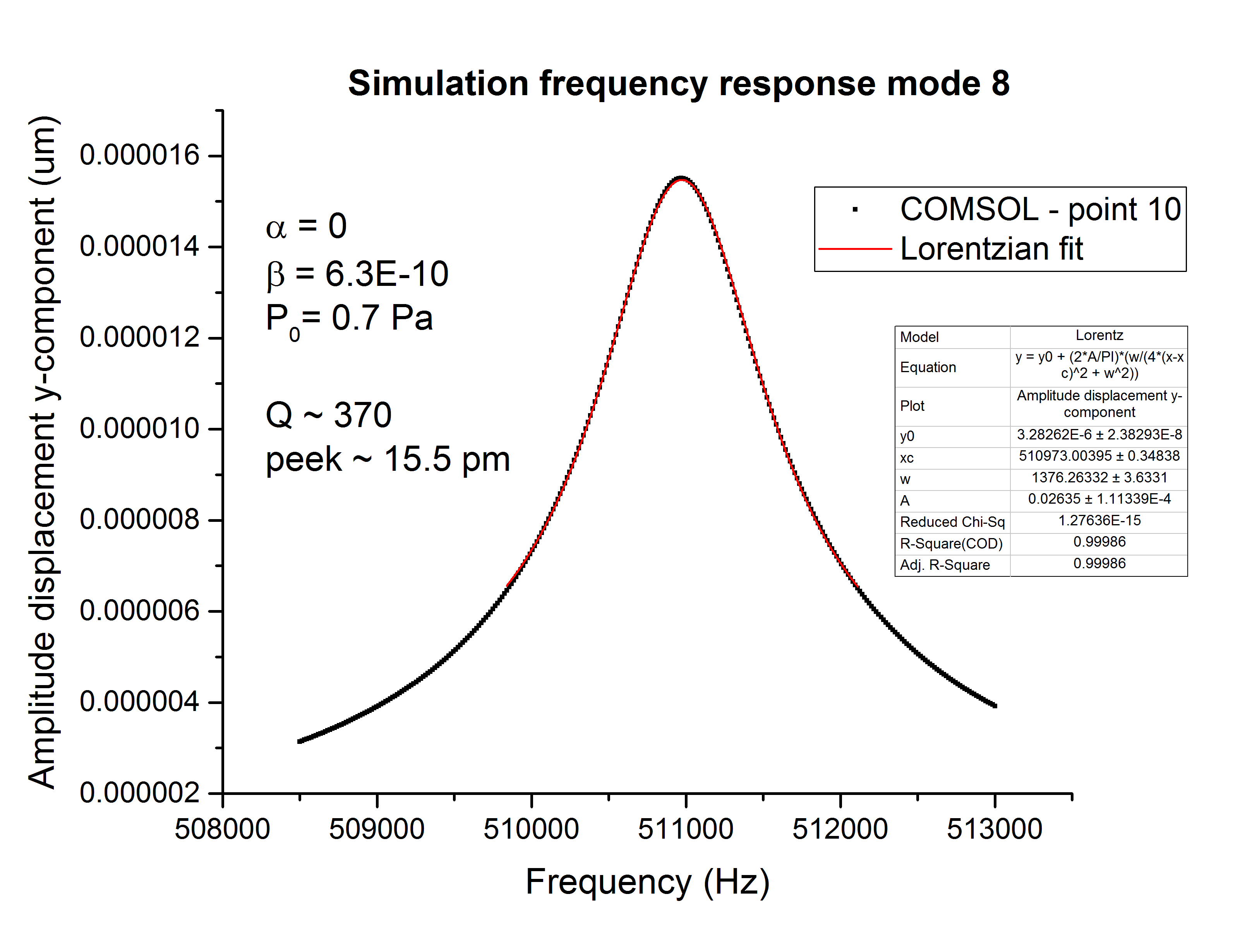

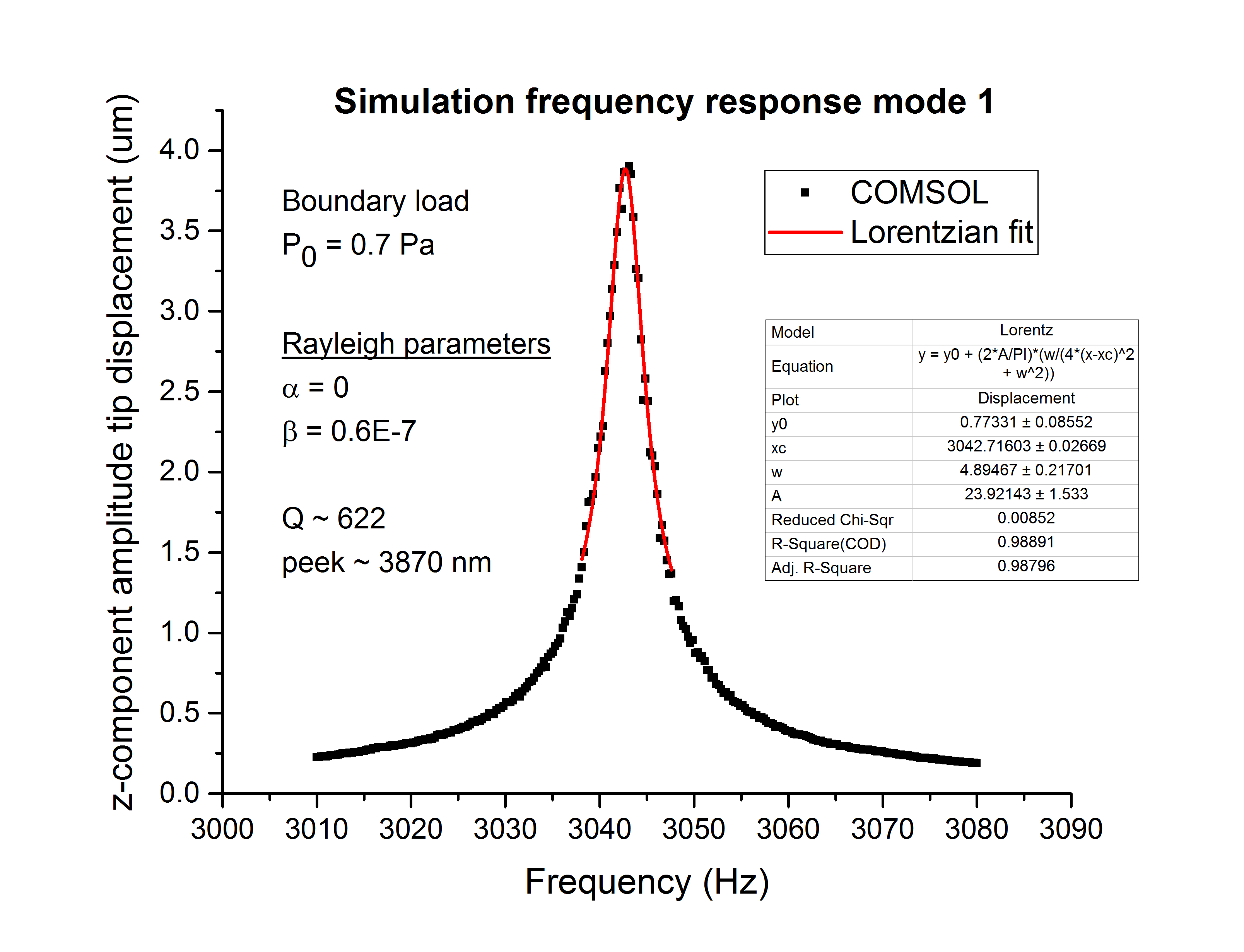

Posted: 10 years ago 2016/02/24 5:02 GMT-5
Dear Ivar,
It has been a while since the last time we had contact. I continued to do some exciting experiments in the lab and now I'm writing my results down, we will soon publish an article about this topic.
In order to understand the data better it is still interesting to know the displacement of the magnetic tip for several higher eigenmodes. I started to do some COMSOL simulations again, see the picture for the 1st mode.
By tuning the damping parameters (or actually only beta and setting alpha to 0) and the driving frequency I managed to reproduce the spectrum we measure around the first mode. However, with these settings I wasn't able to find Lorentzian peeks around other modes, do you know what is going on here? I do however when I disable any damping at all, but I suspect that I actually see Dirac Delta spikes here...
p.s., because I did measurements in the vincity of a Cu plate, the induced Eddy currents coupled to my magnet, that's why we don't measure a Q factor of 30k, but 'only' 500.

Posted: 10 years ago 2016/02/25 2:12 GMT-5
Hi Rembrandt
Good to hear you are progressing, and that the models fit (somewhat).
If I understand your image, you are fitting a Laurentzian function model onto your COMSOL model data.
What I see is that you have a good frequency fit, as both measured and modeled curves are rather symmetric, but their amplitude differs slightly, so you will have (and this is very common for this type of function fits) a far larger amplitude variation between measured (true) modeled by COMSOL and modeled by your fit onto the COMSOL data.
The least square fit averages out the surfaces under the integrals, so if your integration or fitting width (in the frequency domain) is too wide the errors on the base will influence and most probably cut off the top. You should try to plot the max value as function of the bandwidth width you fit over. Then most probably you will notice that the amplitude is rather stable for a narrow width and will decrease or oscillate more as you widen out. Just the contrary for the frequency variable (by the way you need to have a good (lateral) frequency fit to not measure a coupling of both.
So for me this covers the main issues for the one peak and amplitude of the Lorentzian fit (I noticed you have a detailed frequency resolution, and I assume COMSOL calculated all steps so little risk of under-sampling/under-discretization there).
Now why is the COMSOL model not giving you the absolute peak value as you measure it (5700 versus 4000 nm as I interpret it). This can come from the choice of alpha and beta, here you can also add an ODE equation to your physics, define your alpha and beta and optimize them with COMSOL during the solving process (it takes some extra iterations and time though). But then I would recommend that you do it for a region around ONLY one peak, as the optima alpha and beta fitted most probably will vary from peak to peak. If this is still not enough to get to your absolute value then the damping model is not good enough, you have other (non-linear) effects going on the in the true physics, and you need to add some other physics (but like that I have none to propose, or perhaps some bidirectional thermoelasticity, for these small samples its possible ;).
Finally, you say that with this alpha=0 and beta value your multiple peak does not really fit well your measurements, but in frequency or in amplitude or both? The amplitude of the COMSOL model is highly dependent on your damping model, and to some extend to the input load/impulse and how that excitation is propagating through your model, so for the amplitude you are stuck to tweak alpha and beta, or add some other dissipation physics. for the frequency peaks, these depend essentially on the stiffness and the mass, hence stiffness distribution via the material stiffness tensor field properties and model discretization, and the mass depends on the material density field and the geometrical model discretization. But with added damping the frequency also shifts slightly and if you have a damping depending on the frequency value, then this would also influence the peak locations. If you check the doc you will see that alpha relates to the mass matric while Beta multiplies the stiffness matrix. Rayleigh damping is not really physical neither, but its mathematically well behaved for FEM modeling, hence its well used. For frequency sweeps, you can also use the loss Damping (check the doc) and Viscous damping.
By the way, with damping the COMSOL eigenfrequency and frequency sweep results become complex, but the plots of COMSOL are only the real part!
You have checked that you use both real and imaginary and/or amplitude and phase contributions ?
Finally for these small elastic structures, the deformations are often of non-linear geometry type, have you turned this feature on ? It makes the solver slow down, often one need to tweak the solver settings and used Constant Newton, as non-linear method under the Fully coupled solver node, in this case.
So I cannot give you any direct answers, but I hope that my thoughts can give you some clues or arguments to continue.

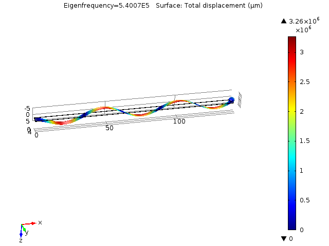

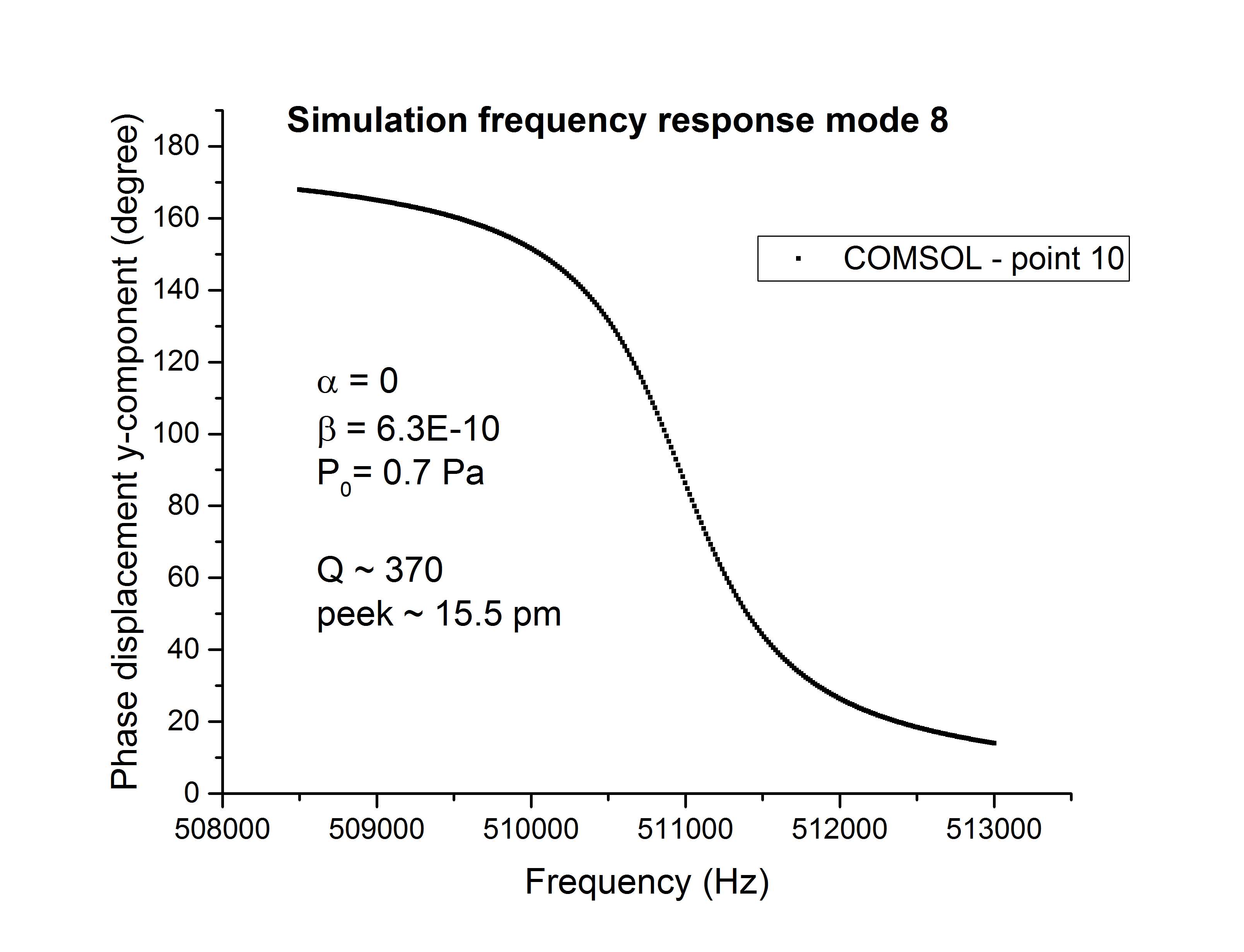

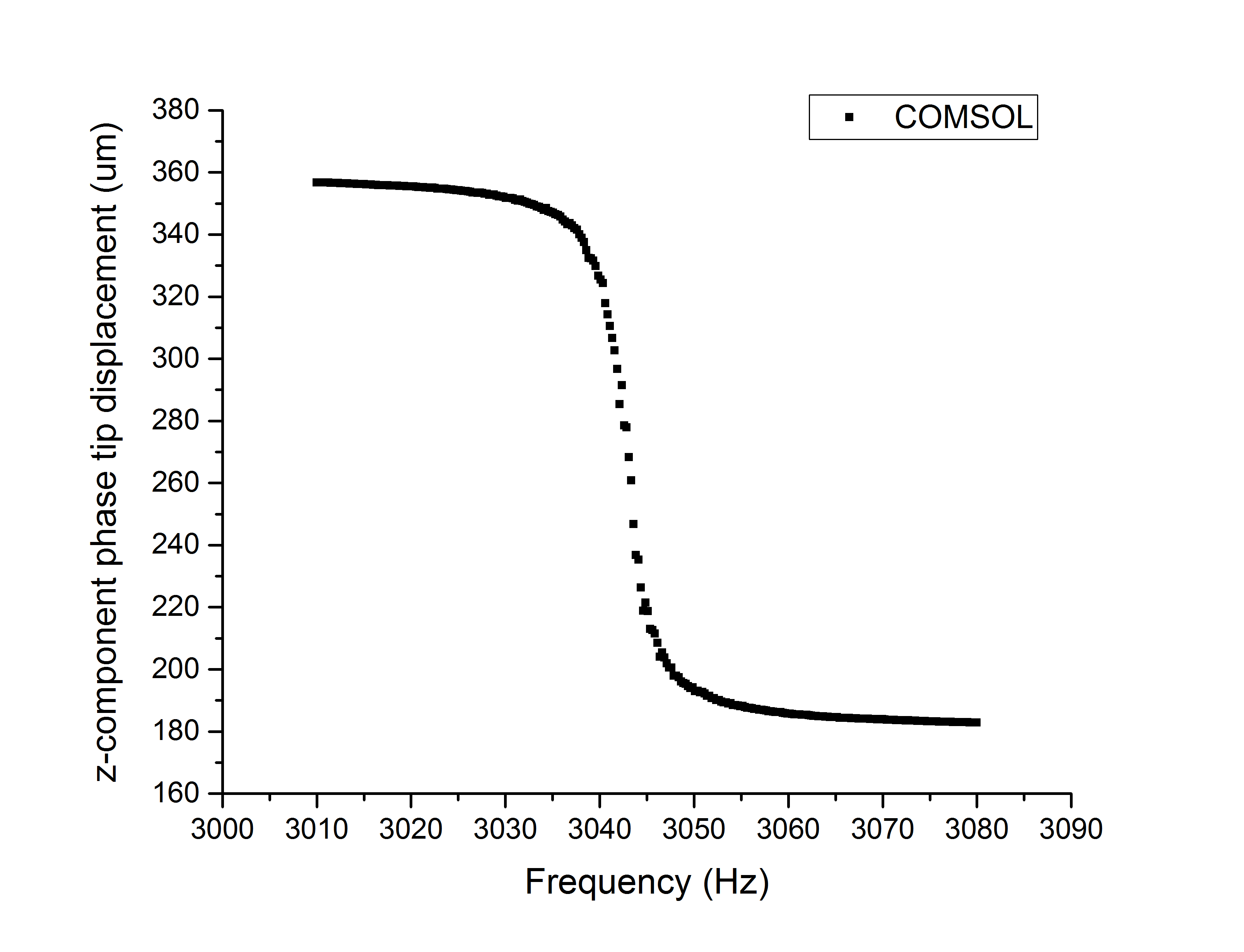

Posted: 10 years ago 2016/02/26 10:08 GMT-5
Thanks for your advise once again!
I have found the heigher mode by adjusting Rayleigh parameter beta (still keeping alpha 0) such that I have a Q-factor at this mode of approx. 500 (as measured in real experiment).
See the results in attachement - this time showing the amplitude and phases and a better fit procedure. Everything looks very fine. However, there must be something COMPLETELY WRONG in the simulation:
The displacement of the tip is of the order picometer. This is way too small (by a factor 200), ie the changing magnetic field we measure at this mode should be explained by the rotational motion the magnet makes, see attachement (the little sphere on the beam is the ferromagnet I am reffering to).
I did the simulation in Comsol as follows - perhaps the way I build the simulation is complety wrong:
1. build cantilever geometry, put a fixed constraint on the side where there is no magnet.
2. find eigenmodes (These DO correspond with real experiment within 10%)
3. minimize #mesh elements such that the solution to find the eigenmodes do not change significantly.
4. frequency domain study at first mode (3000 Hz). Add a boundary load at the tip edge (order 1 Pa). Add Rayleigh damping: when alpha = 0 than beta = 1/(Q*omega_resonance_mode_n). Tune driving load such that the Lorentzian curve peeks around 4000 nm (it is known from experiment that we have this tip displacement at the first mode when driving the cantilever with our piezos, 100 mV).
5. Used the same driving force for a frequency domain study at a heigher mode (mode 8). Recalculated beta for this mode, should also correspond to a Q-value of 500 (found in experiment).
That's it. Maybe it is still the wrong implementation of damping? According to the struc. mech. module it is very commen to set alpha to 0.
Any idea what could have gone wrong?

I'm in high vacuum indeed, the 1 Pa boundary load correspond to the cantilever's driving force exerted by my piezos. As you could see in the graphs I sent you I actually already used a frequency dependent beta to model the damping at the 2 different resonance frequencies, although I have set alpha to 0 at both frequencies.
I could include alpha now to the game (why do they say in the struc mech module that it is commen to set alpha to 0?), and tune alpha and beta at 2 different modes. Maybe that solves my problem of applying the correct damping...

I make my Bode plots as abs(v) of a point at the tip of the beam and the arg() or atan2(imag(v),real(v)) all versus frequency, then I like to use log-log and log plot scales.
I made three beams, in 2D, in steal, 1 m long, 0.02 m thick, one no damping, one with alpha = 100 and the other with beta = 1/100 arbitrary values. Beams are fixed at one end, have 1kPa/m^2 Y load at the other end. I do a fist frequency plot, and a second frequency domain sweep, I tried from 10 to 200 Hz by 1 Hz. but one should also look at higher frequencies to better understand the differences of alpha and beta.
So if you span several modes and a large frequency band you should optimize both alpa and beta to get best values.
Hi Unfortunately I have only 5.2 active ... I make my Bode plots as abs(v) of a point at the tip of the beam and the arg() or atan2(imag(v),real(v)) all versus frequency, then I like to use log-log and log plot scales. I made three beams, in 2D, in steal, 1 m long, 0.02 m thick, one no damping, one with alpha = 100 and the other with beta = 1/100 arbitrary values. Beams are fixed at one end, have 1kPa/m^2 Y load at the other end. I do a fist frequency plot, and a second frequency domain sweep, I tried from 10 to 200 Hz by 1 Hz. but one should also look at higher frequencies to better understand the differences of alpha and beta. So if you span several modes and a large frequency band you should optimize both alpa and beta to get best values. -- Good luck Ivar

I actually did a new frequency study, now just using a isotropic loss factor which was equivalent to the Q-value I want. The result is exactly similar when I used Rayleigh damping with alpha set to 0. I think setting alpha to 0 is equivalent to using just an isotropic loss factor - I read something like that in the struc. mech. module.
I reread all our messages, and I think I still need to try to involve alpha to the game:
Tune alpha and beta for the 2 seperate modes such that I get a flat Q. I hope that will be the key to my problem.
I know how to plot Q VS frequency when I do the frequency domain plot, but how to find a good combination between alpha and beta? The stuff I found on the internet was not helping a lot...
You talked about some old Matlab code that could easily find the right combination (but you lost it). Is there a way to do this optimlization in Comsol?

OK, I found some combinations for mode 1 where I get a pretty flat Q (damping increases linear with frequency, but with a small slope), but any idea if any solution with a flat Q is a 'good' combination? I noticed that for Q = 500 and omega = 3043 Hz, beta converges to a certain value, ie:
beta alpha
100 -925984893.9
1E+01 -92598483.91
1E+00 -9259842.914
1E-01 -925978.814
1E-02 -92592.404
1E-03 -9253.763
1E-04 -919.8989
1E-05 -86.51249
1E-06 -3.173849
1E-07 5.1600151
1E-08 5.99340151
1E-09 6.076740151
1E-10 6.085074015
1E-11 6.085907402
Any experience with this?

OK, I'm a bit further (this question has become a quite obsession) - I did some literature research about damping and I figured out a way to get my alpha and beta tuned - I used 2 frequencies close to the resonance frequency and solved for alpha and beta while keeping the damping parameter constant for both frequencies. I managed to obtain a very flat Q-factor at both modes and till my surprise I still found a very small tip displacement at my higher mode (let's say a factor 10k too small which would be sufficient to fully understand our data).
Is it perhaps possible that my higher mode is 'coupled' to my first mode, even when I drive the system exactly at the higher mode? It could be that the tip displacement motion is is still dominated by the first mode... Is there any way to find out with COMSOL how much 2 modes are coupled?
Thank you very much in advance, I'm looking forward to your insights :-)
