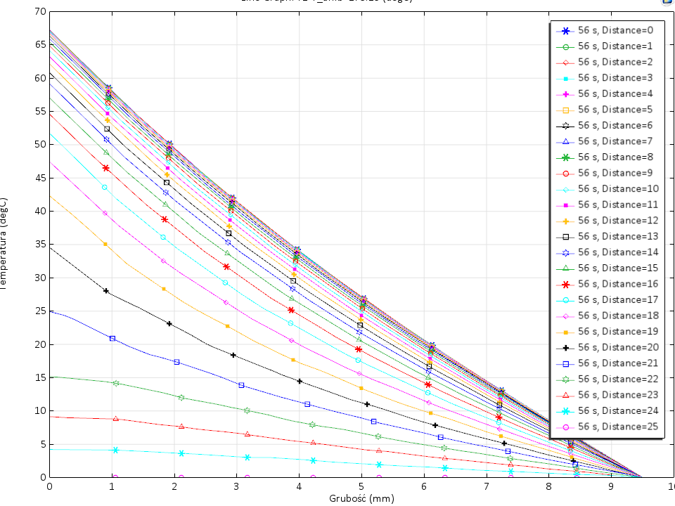

I have a certain surface heat distribution in a disk cross-section - see Pic1.png.
1) I created 2D Cut Line in Data Set with additional parallel lines [range(1,1,25)]
2) I plotted Temperature dependance along red-arrow for these 'parameters' (see Pic2.png).
All works fine. However, I would like to plot average temperature along red-arrow for every 2D Cut Line, literally - average temperature distribution along the radius of the disk.

If I understand correctly, you want to get 25 averages each corresponding to a separate line.
The tedious way is to manually create 25 Cut Line 2D data sets, and manually using Derived Values>Average 25 times to compute the averages.
The easy way is to create a small app that does all the repetitive work for you. See the attached file. Run the application; it should be pretty self descriptive. All it takes is a single method that consists of 3 commands within a for loop, and a single form with two form objects (a button and a table to which the values are sent).
Of course, you will want to prettify it, but it should put you on the right track.

There is another approach, one that does not use an application but adding an extra study instead: see steps 1-5 at this link www.comsol.com/blogs/maximum-e...luations-on-parallel-sections/ . In your case it's an average rather than a maximum that you want to compute, but the idea is the exactly same.
I am attaching a model that demonstrates this.
