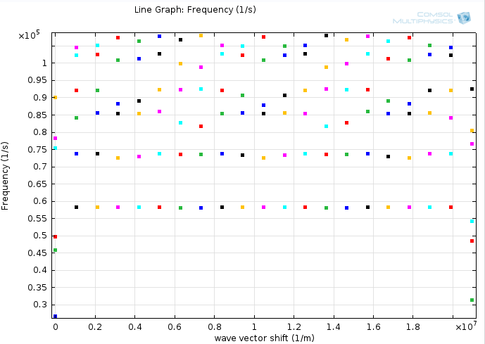

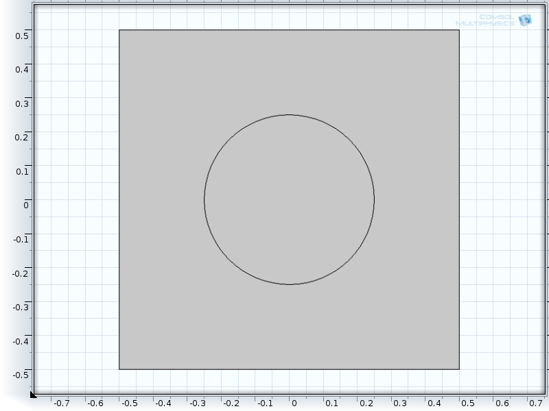

Hi Nagi,
I am trying to get a band structure for a simple 2d sq lattice (solid circle in a solid matrix); but I did not get the z-mode (longitudinal mode), just the transverse mode only , what i did was: (I am using comsol 4.4)
1. used acoustic-structure interaction, elastic wave (elw) module
2. chose both domain linear elastic material.
3. Floquet periodicity (1,4) and (2,3) boundaries.
4. took the parametric sweep for kx = 0 to pi/a
5. finally got kx vs freq (derived values > global evaluation),
but this kx vs freq gave me just transverse modes only, longitudinal mode missing. I am lost. Please suggest me how to get longitudinal modes. Any help would be greatly appreciated.
Also I am having problem with liquid matrix with solid scatterer.
Thank You very much,
Ukesh

i did the band structure for 1D periodic structure of phononic crystal but the curve is not good as show in the attached image .....any one has any help ??
