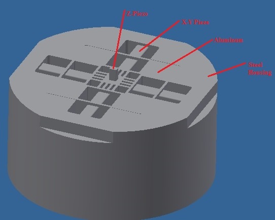

I have already modeled my scanner that consists of a steel metallic outer casing, An aluminum used as the center piece to house 8 piezo ceramic stacks of dimensions 5x5x10 each for the X-Y actuation and Y piezo stack of dimension 2x3x5 mm. The scanner is built on the push-pull principle (See the attached file).
I would like to predict the first resonance frequency in the scanning direction. I just need a clue on how to go about this. In case you need further clarification kindly let me know.
