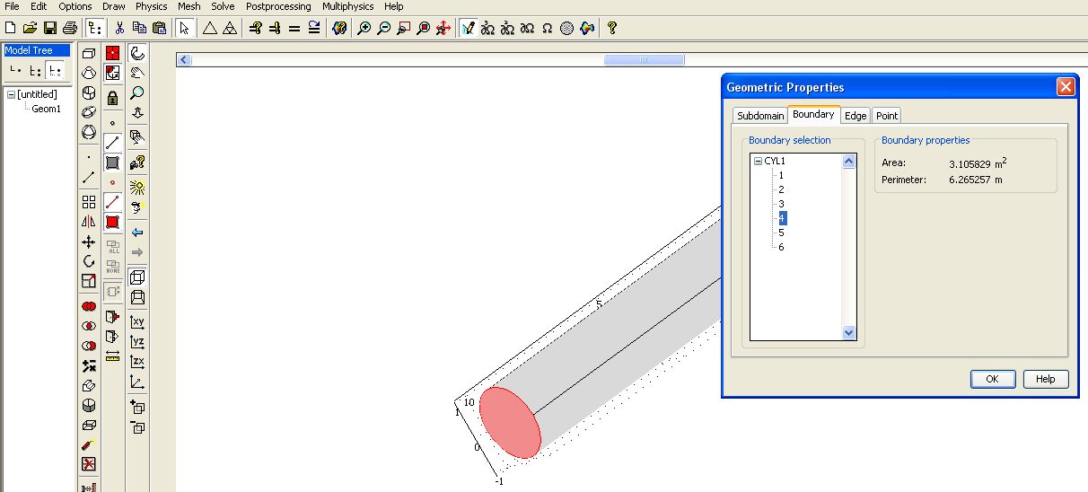

1. if we draw a cylinder with unit radius(R=1) and if we want to see the face area it should be (Pi*R^2)
i.e (Pi*1^2) = value of Pi = ~3.1415926535897932384626433832795
but in comsol it shows ~3.105829 why??? so much error and how to minimize it???
2.During the simulation why in my task manager only single core is loaded other three cores of the processor are not loaded??
3. If i want to improve my system what aspects i have to consider. I meant is it anything to do with hardware or software improvement that is causing the problem?

"Oh i forgot one more thing
but in comsol it shows ~3.105829 why??? so much error and how to minimize it???"
Your mesh may be too coarse. Try refining, update model and recalculate are- it should converge to true value of pi.

Hello Ozgur Yildirim,
I have not mesh the geometry. I have just generated a cylinder of Radius 1 meter and height 10 meters. If you have comsol plz try in. to see the geometrical property of the cylinder i went to Comsol>Draw> Geometrical Properties> Boundries.
And if you can address my above problem as well.. it could be a great help.
