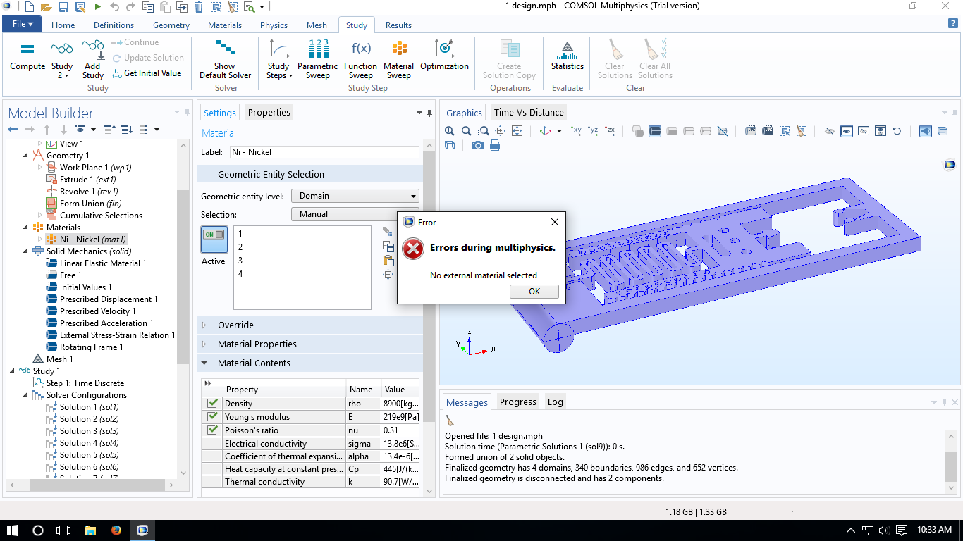

I am trying to compute study using stationary.. but getting add external material error. Figure 3
Already added material and do not want to add any external material. I have also tried to eliminate this error but system wants me to create .dll file to add external material and I do not want to add this.

The 'External Stress-Strain Relation' node which you have in the model tree is the way to call an external material.
An external material is one which you have coded yourself, and compiled into a .dll file. If that is not your intent, you should not use the 'External Stress-Strain Relation' as material model.
