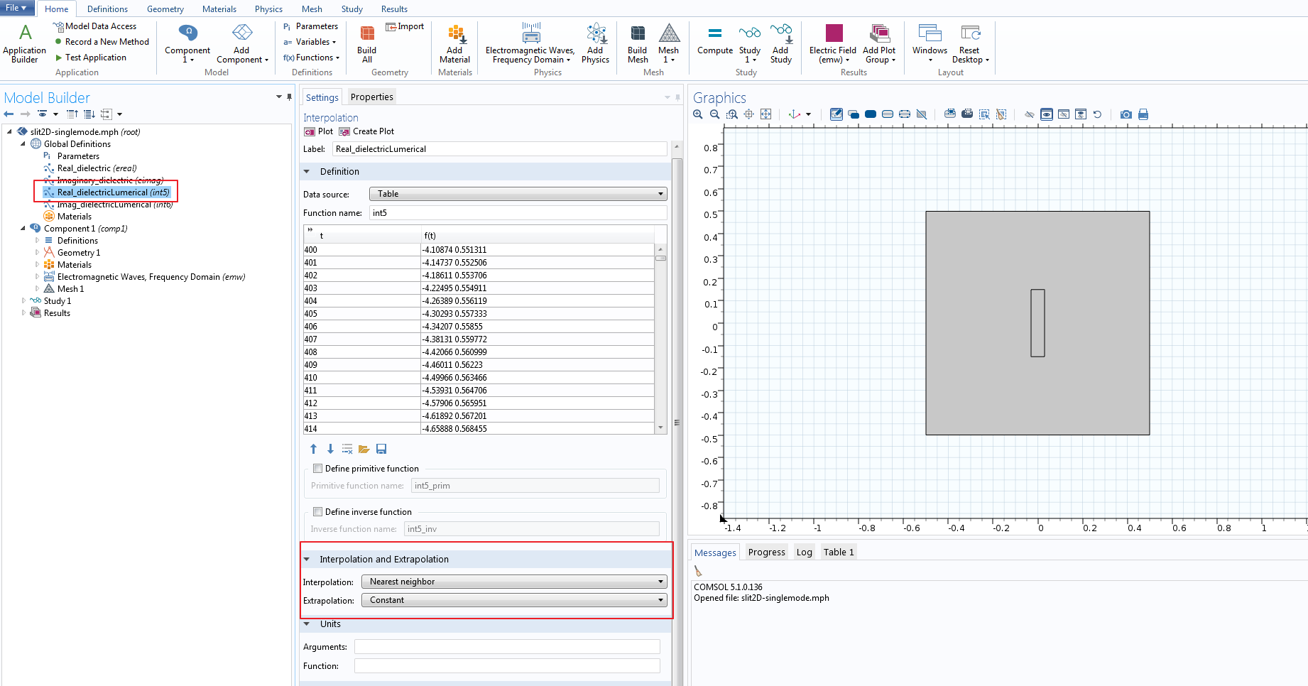

I would like to use the relative permittivity fit for silver provided by the FDTD Solutions software by Lumerical. I exported this fit as two ASCII text files consisting of two columns separated by spaces. The first file contains the wavelength vs. real part of the relative permittivity, whereas the second file contains wavelength vs. imaginary part of the relative permittivity. My aim is to use the data as it is without any interpolation. There is only interpolation function which allows me to import this function and that is exactly why I posted this thread. How can I do so?
Thanks in advance
P.S: I am working with COMSOL 5.1 RF Module on Windows 7. I have also attached a relevant screenshot.

Create interpolation function int1 using the first file containing the wavelength vs. real part of the relative permittivity. Create another interpolation function int2 using the second file containing the wavelength vs. imaginary part of the relative permittivity. Then, define relative permittivity as following:
eps_r=int1(c_const/lam)-j*int2(c_const/lam)

Thanks for the suggestion, I did as you instructed and it worked. However, I do not want Comsol to interpolate the data in any case. How can I achieve this behaviour(it can return an error when a wavelength not in the table is selected)? This is crucial as I want to have consistent results between Lumerical and Comsol.

Run your calculation only at those wavelengths, that are in your table. Than the refractive index will be exactly as in the table, and in Lumerical.
