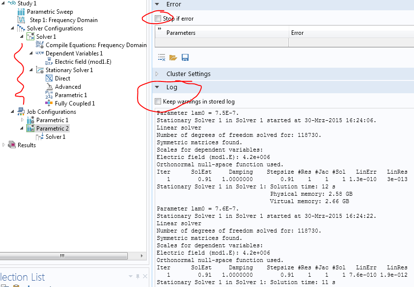

                                                    Hi Rui,
This happens for me sometimes too. The reason in my case was, that I had some errors during parametric sweep. I sad comsol to ignore the errors in the sweep, and hence some data points was missing in the “Accumulated Probe Table”. If this is the case in your calculations you can check by looking at the log files, which you can find under the study tree, take a look at the attached image. You can also find at the screenshot how to let comsol ignoring errors during the parametric sweep.
There could be different reasons for errors, based on the logs one can determine how to get read of those.
Please also keep in mind that “Filled tables can only be produced by studies that have All combinations selected in their parametric sweeps.” as the documentation says.
Edit: If you have your dada-table generated successfully, you can try to play with the “Presentation format” of the table. The default setting is “All”, you can choose “Filled” and select needed variables. Do not forget to press “Update” at the top of the settings.
Maxim

                                                    Hi Rui,
"attached image" is the image attached to the post in the comsol discussion thread, you can download it and open.
Regarding three variables plot, yes it is possible with standard tools. You just have to define the parametric sweep with sweep over two variables and “All combinations selected in their parametric sweeps”. If there is no errors, you can plot it from the appropriate table.
I am currently working with the 5.1 version of comsol.
Maxim
