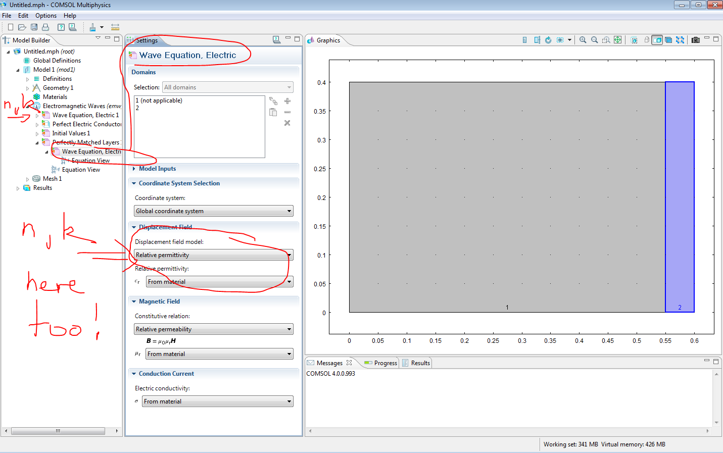

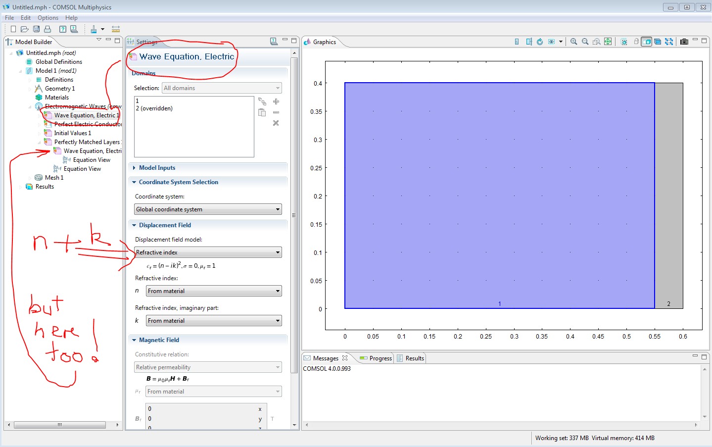

As I said above, but I did not expalin it well enough, n,k must be set in TWO different places for RF, in the main "Wave equation" setting (capture.png) AND in the Wave Equation sub-node of the PML node (capture1.png)
This is easily forgotten, but if you have set both correctly, then you have another isue, that I do not understand ;)
Hi As I said above, but I did not expalin it well enough, n,k must be set in TWO different places for RF, in the main "Wave equation" setting (capture.png) AND in the Wave Equation sub-node of the PML node (capture1.png) This is easily forgotten, but if you have set both correctly, then you have another isue, that I do not understand ;) -- Good luck Ivar
